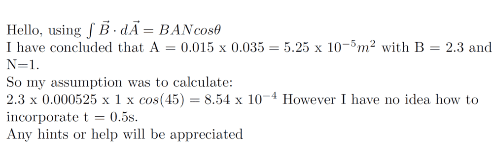

A rectangular single loop of wire of length 0.035m and width 0.015m is positioned at 45° to a uniform magnetic field of 2.3T. The loop is rotated through 45° so that its plane is parallel to the magnetic field. Determine the electromotive force (e.m.f.) induced in the loop if the rotation takes 0.5s
emf = BAN cosθ
242410

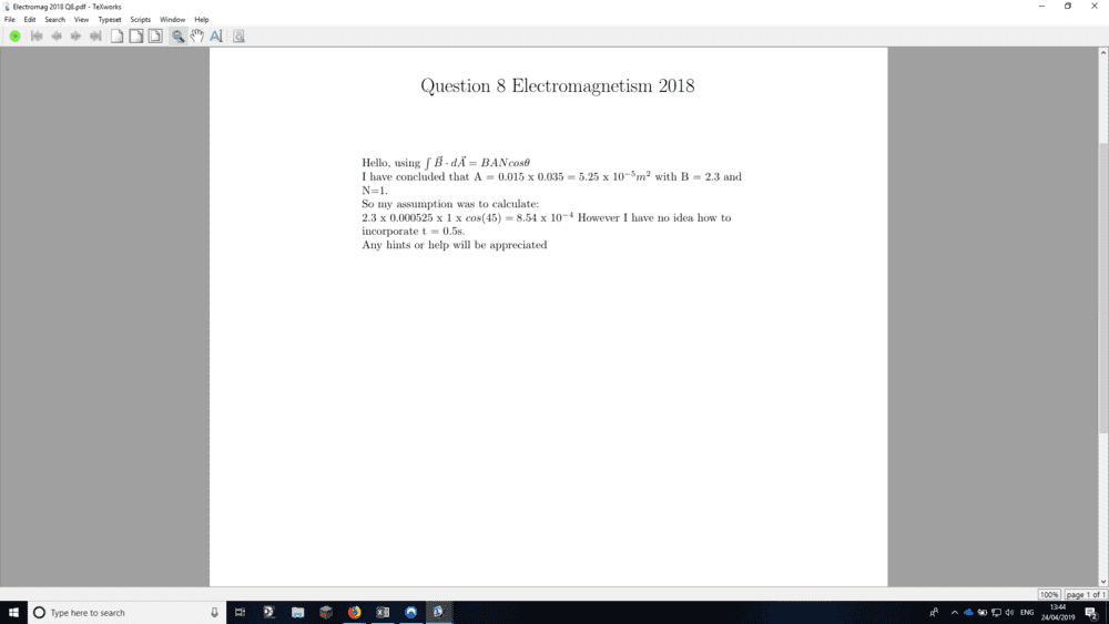

  • Screenshot of a LaTeX PDF titled Question 8 Electromagnetism 2018, showing a typed working using the flux integral of B dot dA = BAN cos theta, with values A = 0.015 x 0.035 = 5.25 x 10^-5 m^2, B = 2.3, N = 1, and a substitution with cos(45).
Hi, so you have calculated the flux [itex]\Phi_B = \int \vec B \cdot d\vec A[/itex], but what is the relationship between Emf induced and the flux? Have you heard of Faraday's Law, which states that the emf induced is given by [itex]Emf_{induced} = -N\frac{d\Phi_{B}}{dt}[/itex]. If you are assuming that this rotates at a constant speed, then you can change the formula to [itex]Emf_{induced} = -N\frac{\Delta \Phi}{\Delta t}[/itex].
Hope that is some help. I can answer more questions, but I am trying not to give the answer away.
Hello, thank you for your message! After some thought and looking around in textbooks etc. I believe that by using [itex]Emf_{induced} = -N\frac{\Delta \Phi}{\Delta t}[/itex] I have calculated the Emf to be [itex]-1\frac{0 - (8.54\text{ x }10^{-4})}{0.5} = 1.708 \text{ x } 10^{-3} \text{ V}[/itex]
I hope this is correct?
