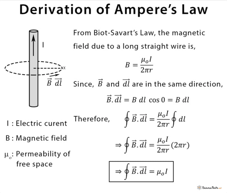

For a current-carrying cylindrical wire that's infinite in the ##z##-direction, just use Ampere's Circuital Law to get the magnetic field ##\vec B## outside the wire. Here's a simple illustration from https://www.sciencefacts.net/amperes-law.html:
Here ##\vec B## points in the ##\hat{\phi}##-direction of cylindrical-coordinates centered on the wire. That was easy!
The tricky part will be to form a finite-width current sheet by carefully summing the various fields that arise from ##N## wires placed parallel to each other and spaced a distance ##d## apart to get ##\vec B_{\text{total}}(N,d)##, and then taking the limit as ##N\rightarrow\infty,d\rightarrow 0##.
