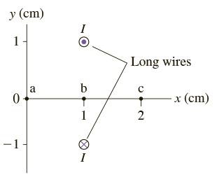

Assume that I = 5.0A.
What is the magnetic field at point b in the figure? Give your answer as a vector.
Ampere's Law - B = (μ0I)/(2πr)
I tried plugging the given numbers into Ampere's Law for point b, which gave me B = (4π*10-7) *5.0 I/(2π*0.2 cm), or a result of 1*10-5 T pointing in the positive direction. I assumed this should be doubled as there are two identical fields, giving me 2*10-5 T, but this is wrong. Any help on where I went wrong would be appreciated.
Hello, winterbell and welcome to PF!
winterbell said:
I tried plugging the given numbers into Ampere's Law for point b, which gave me B = (4π*10-7) *5.0 I/(2π*0.2 cm), ...
Where did the 0.2 cm come from?
Also, should r be in cm or meters?
r should be in metres - having gone back and checked I realized that I should actually have had an extra 0 in there and it should have been 0.01 m. I should probably check my values better as I seem to often have problems with this!
Thanks for your help.
