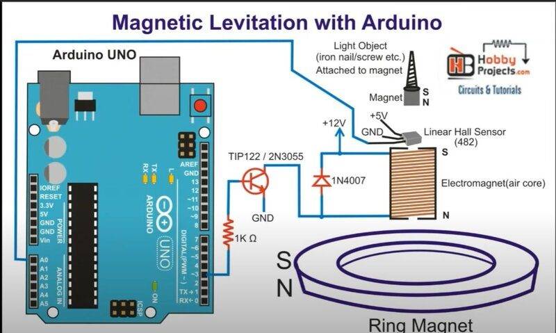

I mostly used the set up shown on this article: (https://www.instructables.com/Arduino-Air-Bonsai-Levitation/) but when coming to the actual testing, no repulsion was happening, but instead was the burning of the plastic on the jumper cable occurred as it was connected to one of the copper coils. Unlike when the parts were attached to its original products, there was no suspension happening, and instead violent crashes and/or nothing.
I even tried doing it with one copper coil (120m, turns number unknown) with a ferrite core. The set up for this test was just one copper coil inside a ferrite ring magnet with a ferrite core (10mm diameter, 50mm height) using the schematics shown in this video (I did not use a Diode though) (https://gyazo.com/6f4fc0b56f6245a03af7b6761fd177af)

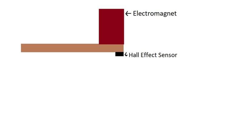

Third experiment would just be the electromagnet but levitating the object below the solenoid. The core, as before, would be a ferrite core(as for some reason, Iron rods have disappeared from the market completely). The electromagnet would basically be on top of my desk, with the hall effect sensor being below the desk looking something like this:
The Hall sensor would be connected to my Arduino, sending information of how close a magnet would be to itself and having the magnet apply repulsive or attractive strength depending on the distance of the magnet(basically similar concept to previous experiments) I was fairly confident that something like this would be simple enough as hanging systems often tend to be more stable, what also boosted my confidence was the current being given to the system through the 12V 2A input, as 2A being applied to a 120m (unknown turns) coil would generate a lot of attractive force. I used the same code as the single electromagnet one, but yeah I underestimated the difficulty of the project and got it wrong, again.

You will also be dealing with enormous "flyback" voltages in the control loop; i.e., the power supply has to be well protected.
I would definitely put a diode in the circuit in the direction of A0 or a LPF before A0.

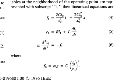

Woomir said:
Hi thanks for your response, are you able to explain why papers around magnetic levitations often have the f(x,t) = i^2/2 dL(x)/dx ? Furthermore, how does C(i/x)^2 come about?
Reference papers:
Design and Implementation of a Controller for a Magnetic Levitation System YING-SHING SHIAO
https://gyazo.com/7e2d5863e0c164cc8949476dd8f92c37
https://ieeexplore.ieee.org/stamp/stamp.jsp?tp=&arnumber=5570565
I don't know the details of the derivation for this setup in the paper but in general, if you look at the Feynman Lectures of Physics Vol 2 chapter 17 page 13 you will see in the case of two coils carrying currents ##I_1## and ##I_2## the force between them is of the form ##F \Delta{x} = I_1 I_2 \Delta{M}## where ##\Delta{M}## is the change in mutual inductance. That is the same form as the equation you quoted above. In the paper ##L(x) = L + \frac{L_0X_0}{ x} ## so they set ##C=\frac{L_0X_0}{ 2}## for convenience.

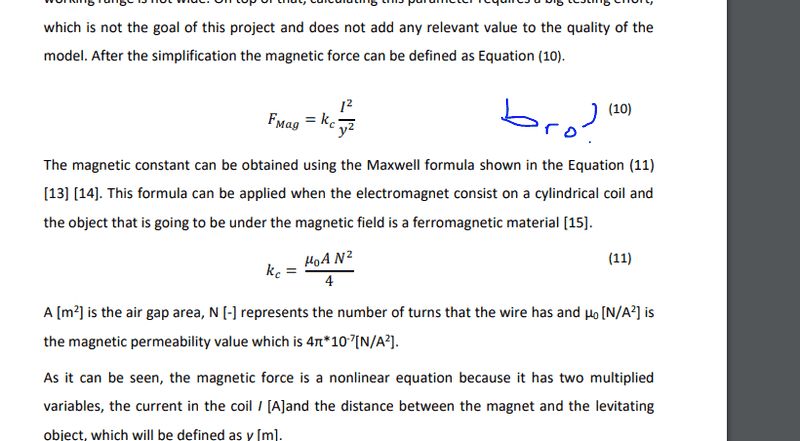

Okay so I checked the book out along with an Electric Machinery book and yeah it makes a lot of sense now. However, C is still bugging me, but for a different reason now.
You know for a fact that C=\frac{L_0X_0}{2}, which is clearly apparent as there are textbooks and guides both on the paper and the books you linked showing that this is the case, yet tell me how each of the authors of these papers later obtained values for C? It's Units are in N*m^2/A^2 and I'm genuinely confused as to how I'm supposed to actually get these values for my project. The papers don't explain how you get them, other than mentioning the words "inductance" and nothing else other than straight up showing that the C that was formerly C=\frac{L_0X_0}{ 2} somehow has a value of its own now.
Examples:
[Figure 1] Taken from T.H. Wong's paper: Design of a Magnetic Levitation Control System?An Undergraduate Project. https://ieeexplore.ieee.org/document/5570565
[Figure 2] Taken from Juan Sebastián Lafuente Larrañaga's paper: Design and Development of a Digitally Controlled Magnetic Levitation System https://addi.ehu.es/bitstream/handle/10810/36694/MasterThesis.pdf?sequence=1&isAllowed=y
The below papers are conflicting in a sense that they have different methods of obtaining C and the Inductance L(x) = L + \frac{L_0X_0}{ x}, but overall the same in units, as each of them always get the units of N * m^2/A^2
where:
N must be Newton
m = ??
A is Area
Bibliography (Other papers which basically do the same thing):

I think ##m## is meters and ##A## is Amps.
How do i determine/calculate this "magnetic constant" though?
I have to look into it...
Ok, let me correct myself. If you were referring to formula 11 in your figure
$$k_c = \frac{\mu_0 A N^2}{4}$$
then ##N## is the number of turns of wire in their setup, ##A## is area in ##m^2## and ##\mu_0## is the magnetic permeability in units of ##\frac{N}{A^2}## where here ##N## is Newtons and ##A## is Amperes.
I just came back with a fresher mind on things, and I just realized this.
It's true that each author of the paper have their own experimental calculations for determining the inductance change over distance with a ferromagnetic object. This, when combined with the Faraday inductance energy stored, create an equation of the electromagnet's force in respect to distance and current.
You basically get the above result when combining the inductive equation for energy, inductance depending on distance and application of Taylor Series.
Since the system is not linear, Taylor's Series had to be applied as you can see the results above. An assumption had to be made(like other papers) that $$C\frac{i_0^2}{x_0^2}$$ was the force required to first lift the electromagnet, along with what you see as f1 being the linear dynamics required to keep the levitated object stationary. This would make $$f_0$$ as shown in the above figure, equal to mg, as mg is basically the weight of the ball.
Then it hit me, why don't I just equate the two? Surely if $$mg = C\frac{i_0^2}{x_0^2}$$ then would it not be logical to say that $$C=mg\frac{x_0^2}{i_0^2}$$ when rearranged? I was shocked when I missed that, because it made sense to remove it the first time, but did not even hit me when I realized I could actually equate C to mg(weird).
But my issue now is finding the distance and current. What am i supposed to do for them? Is that just the amount of current needed to lift a weight of mg over x distance?
