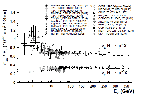

  • #75
Vanadium 50 said:
I can run the current in the neutrino horn and get positive leptons in the detector, and then switch the current direction and now get negative leptons in the detector. This is not theory - this is an observed fact.
Can you be more specific about which experiment this refers to? The only specific experiment you've referred to so far is the Cowan Reines experiment, which used a nuclear reactor as the neutrino source and so could not choose what kind of neutrinos were being detected--it was whatever kind were being emitted by the nuclear reactions in the reactor. What you're describing here seems like a neutrino source where we can choose what kind of neutrinos it emits at will.
