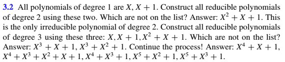

F2 = (0, 1)
To this exercise,
the textbook's solution is
I didn't follow their method and have found another degree 5 solution, ##X^5+X^4+X^2+X+1##.
Is it wrong or the book has omitted this solution?

It is irreducible. I guess they missed it.

As well as
##X^5+X^4+X^3+X+1##
##X^5+X^3+X^2+X+1##
##X^5+X^4+X^3+X^2+1##

Yes.
There are six of them.

This seems a little easier than the book's hints make it. A poly. over Z/2 is divisible by X or X+1 iff it either ends in X or has an even number of terms, hence the irreducible cubics end in 1 and have an odd number of terms, i.e. X^3+X^2 + 1, and X^3+X+1. A reducible quartic or quintic either ends in X or has an even number of terms or is divisible by X^2+X+1....It is still somewhat tedious, but maybe not as long as multiplying together all those factors to compute all reducible examples. It is interesting that after all these years I still have trouble checking irreducibility. I guess it is just inherently difficult. Such problems have been challenging for years in algebraic geometry: Severi's conjecture, irreducibility of moduli of curves, components of Hilbert schemes,....
