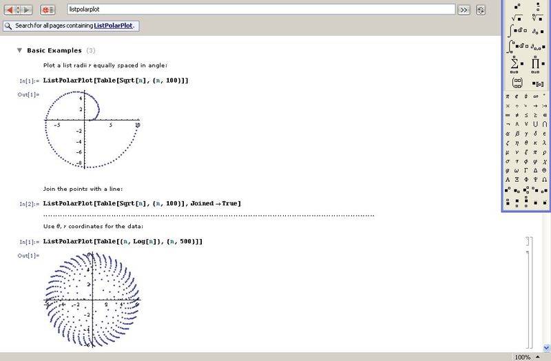

I'm doing research with my professor, and as an 'easy project' (har har) she gave me the task to replicate the CFA Redshift Survey in a polar graph plot. So with some clever googling I found the .dat file that has the most recent info in it, and I'm fairly confident I know which numbers to plot vs what and how to bound it and all, but the whole process of actually importing the data and plotting the points is a pain. Anyone have any ideas?

Thank you x a billion, enuma, but now that I have my data in it, how would one plot this wackyness as a function of radial distance vs angle? eg, plotting data points in polar coordinates?
If you go to Math'ca help (F1 on the keyboard) then type "polar" as the search term, you'll see (among others):
ListPolarPlot[{r1, r2, ...}]
plots points equally spaced in angle at radii ri.
ListPolarPlot[{list1, list2, ...}]
plots several lists of values.
I guess I misspoke (mistyped?) when I said 'polar'. Pretty much I have to replicate http://cfa-www.harvard.edu/~huchra/2mass/images/cfa2.n30.gif" . I have the data, I just don't know how to fumble with the plotting tools, since excel doesn't fit the bill.
Does the ListPolarPlot function allow me to plot like in the link above?
Carefully look at the examples under ListPolarPlot help.
ListPolarPlot[Table[Sqrt[n],{n,100}]] will produce a conch (spiral) pattern. Note that
Table[Sqrt[n],{n,100}] = {1., 1.41421, 1.73205, 2., 2.23607, 2.44949, 2.64575, 2.82843, 3., 3.16228, 3.31662, 3.4641, 3.60555, 3.74166, 3.87298, 4., 4.12311, ..., 10}. If your data look like these numbers, ListPolarPlot will produce this pattern.
ListPolarPlot[Table[{n,Log[n]},{n,500}]] will produce a starfish (?) pattern. Note Table[{n,Log[n]},{n,500}] = {{1, 0.}, {2, 0.693147}, {3, 1.09861}, {4, 1.38629}, {5, 1.60944}, ..., {500, 6.21461}}. If your data look like these pairs of numbers, then ListPolarPlot will produce this pattern.

Looking at the sky plot you posted, I suspect that your data are in sky coordinates (altitude, azimuth). If so, you need to transform your data points into an (angle, radius) representation before you plot them using ListPolarPlot.
In Math'ca help, the input line that produces the spiral pattern consists of a list of numbers. Math'ca interprets each of these numbers as a radius (and plots them with uniformly spaced angles).
The input line that produces the starfish pattern consists of a list of number pairs. Math'ca interprets the first element of each pair as an angle and the second element of the pair as a radius.
