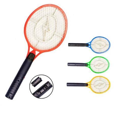

If those tennis racket bug zappers do it with a 9V battery, why can't you do it with a 9V wall wart? That would get rid of many of the safety concerns.
There are numerous mains powered zappers on the market. I saw one for only $30. But the main thing it has that you don't is UL listing (what is the Euro equivalent of Underwriters Laboratory?). Here on PF, we can only discuss the hazards that you or we think of. UL does an inspection of the final device looking for hazards, and they are specialists on hazards.
Fluorescent light.

Surely a 9V adapter boosted to 1400 V is as safe/dangerous as an isolated mains supply, also boosted to 1400 V? This is not to be a hand-held device, but mounted high up on a wall somewhere.

Nope, not true. It is not just voltage, but also the energy that can be delivered in a short circuit pulse. Have you ever gotten a static electricity shock from your car? You can generate as much as 30KV voltage with the seat of your pants against the car seat. But it is not injurious because there is very little energy at that voltage. It is the same with the zapper. It has enough energy to zap a fly, but not enough energy to kill you if you touch it. Compare it with a police Taser.

Ah, yes. I meant if both the 9V adapter and mains versions were configured to deliver the same energy, which they would be if set up to achieve the same end (dead fly).
For example, the CW multiplier I have made is current-limited to 10mA. If building a 9V-powered version, it would also have to deliver 10mA at the same open-circuit voltage (1400V).

But that ignores what I said about short circuit. To get a short circuit, something has to be wrong, or something fails, or something not wired right in the first place.
You reminded me of a personal example. 52 years ago in EE lab, they told me to build a circuit for something simple. When I first turned it on, there was a flash and a bang, and it blew the 400 amp fuse for the entire lab. The problem was a component that shorted against the metal chassis. It was a type of fault that can not be deduced from the circuit schematic; but only by inspecting the finished product before it blew up. [By the way, they never let me make anything in EE lab again, and pushed me toward mathematical analysis of circuits. :smile:]
Back to your project, there is nothing a mains supply can accomplish that a 9v version can't do also.

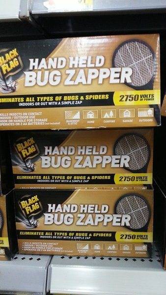

And here's the voltage of one of those handheld bug zappers that sort of resemble a ping pong paddle. Saw it at Walmart today. Looks like you found the correct voltage.

I haven’t managed ‘2750 volts of power’ yet, but I’ll keep trying!
