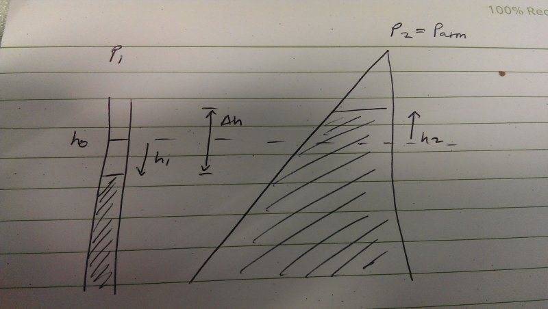

I am trying to establish a mathematical relationship between heights h1 and h2 (please refer to figure attached) for a manometer whose RHS channel is the shape of a triangle (defined by a base length and the angle theta). I want to be able to calculate the heights h1 and h2 for a given change to the pressure p1. Any help or a point in the right direction would be much appreciated.
Regards,
ps. This is not an practice question, I am hoping to do this with multiple manometer with various geometries.
  • Hand-drawn sketch of a manometer: left tube labelled p1 with fluid heights h0, h1 and a delta-h marker, right vessel is a triangle-shaped channel labelled p2 = p_atm with fluid height h2 marked.

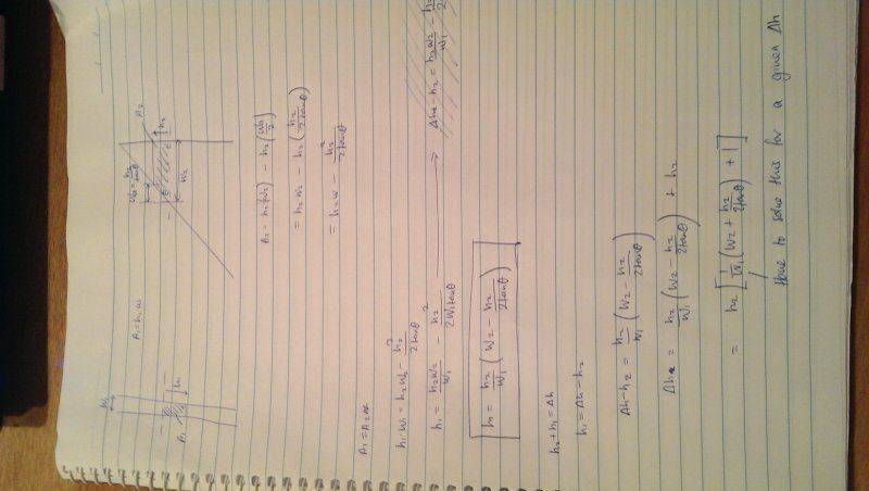

Handwritten derivation on lined paper, rotated, of manometer heights h1 and h2 in terms of a height change Δh, with a sketch of an inclined-tube manometer at top left and final boxed expressions for h2 and Δh.
here is my attempt to get h1 or h2 interms of Δh. Anyone know a cleaner way in doing so?
