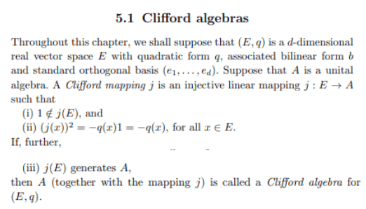

I am referring to the following definition of a clifford algebra:
But I believe it is equivalent to the quotient algebra definition. My understanding of clifford algebras is quite basic, I hadn't really studied its definition as a quotient algebra, but, if I understood correctly, the equivalence classes satisfy ##[w\otimes w] = [Q(w)] \in Cl(W,Q) = T(V)/\mathcal{I}##, then I represent this as
$$w\cdot_{Cl} w = Q(w)\cdot_{Cl} 1_{Cl}$$
Or, equivalently (I think), using the clifford mapping ##\phi##
$$\phi(w)\cdot_{Cl} \phi(w) = Q(w)\cdot_{Cl} 1_{Cl}$$
Is this correct?

Yes, except that it should be ##w\cdot_{Cl} w=-Q(w)\cdot 1_{Cl}.## We imitate the imaginary unit!
