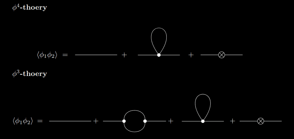

Consider $\phi^4$ theory described by
$$\mathcal{L} = \frac{1}{2}(\partial_\mu \phi)^2 +\frac{1}{2}m^2\phi^2 - \frac{\lambda}{4!}\phi^4.$$
We want to renormalize the theory. Assume that the renormalization for the 1PI 4-point function has been done, resulting in a shift of $\lambda$, i.e.
$$\lambda_{r e n}=\lambda+\frac{\lambda^{2}}{32 \pi^{2}} \int_{0}^{1} d x\left[3\left(\frac{2}{\varepsilon}-\gamma_{E}+\ln (4 \pi)\right)-\ln \left(m^{2}-4 m^{2} x(1-x)\right)-2 \ln \left(m^{2}\right)\right].$$
We are left with renormalizing the 2-point function. Show that the renormalized mass ##m_{ren}## is given by
$$m_{r e n}^{2} = m^2 + -\frac{\lambda}{2(4 \pi)^{\frac{d}{2}}} \frac{\Gamma\left(1-\frac{d}{2}\right)}{\left(m^{2}\right)^{1-d / 2}}.$$
All given above.
Before I start, let me say that I have looked into textbooks and I know this is a standard problem, but I just can't get the result right...
My attempt goes as follows:
  1. We notice that the amplitude of this diagram is given by $$\begin{align*}K_2(p) &= \frac{i(-i m)^{2}(-i)^{4}}{\left(p^{2}-m^{2}+i \epsilon\right)^{2}} \frac{1}{2} \int \frac{-i \mathrm{~d} \ell^{4}}{(2 \pi)^{4}} \frac{1}{\ell^{2}-m^{2}+i \epsilon} \frac{1}{(p-\ell)^{2}-m^{2}+i \epsilon}\\&=: \frac{i(-i m)^{2}(-i)^{4}}{\left(p^{2}-m^{2}+i \epsilon\right)^{2}}i I\left(p^{2}\right).\end{align*}$$
  2. We then remember that the 2-point function can be expanded as shown in this diagram. The amplitude of this diagram is then given by $$ \begin{align*}K(p) &= \sum_i K_i(p)= \frac{1}{p^{2}-m^{2}+i \epsilon} \sum_{j=0}^{\infty}\left(\frac{m^{2} I\left(p^{2}\right)}{p^{2}-m^{2}+i \epsilon}\right)^{j}+\ldots \\&= \frac{1}{p^{2}-m^{2}-m^2I(p^2) +i \epsilon}+ \ldots.\end{align*}$$ If I'm not mistaken, this is essentially what one finds in Peskins book in eq. (10.27).
  3. What we now need is a renormalization condition. This was provided as a hint to the exercise and is given by $$K(p) = \frac{i Z }{p^2-m_{ren}^2}+(\text{terms regular at }p^2=m^2).$$ Note that ##Z## is defined by ##\sqrt{Z}\phi_{ren}=\phi##.
And this is essentially where I'm stuck. First of all, I don't really understand what "terms regular at ##p^2=m^2##" is supposed to mean. One can of course now write down $$\frac{i Z }{p^2-m_{ren}^2}+\ldots = \frac{1}{p^{2}-m^{2}-m^2I(p^2)}+ \ldots,$$ but how am I supposed to extract ##m_{ren}## and ##Z## out of this? In Peskin's book they now explain that this renormalization condition can be restated as
$$I(p^2)|_{p^2=m^2}=0 \quad\text{and}\quad \frac{d}{dp^2}I(p^2)|_{p^2-m^2}=0.$$ Assuming this is true (I need to think about this a bit more...), how is one supposed to find ##m_{ren}## and ##Z##?

The physical mass ##m_{\text{ren}}## is the value of ##p^2##, where the propagator has a pole, i.e., you have to solve for
$$m_{\text{ren}}^2=m^2[1+I(m_{\text{ren}}^2)].$$
Note that this is not ##\phi^4## theory but the one-loop self-energy of ##\phi^3## theory. Here you'll get a non-trivial ##Z## because of the opening of the two-particle contribution to the spectral function. It's nicely explained in the manuscript how to calculate it in the given order of the coupling, ##\kappa^2## or ##\hbar^1## (one loop) on p. 11.1ff. Also note that the author obviously uses the east-coast convention for the Minkowski pseudo-metric, i.e., ##\eta_{\mu \nu}=\mathrm{diag}(-1,1,1,1)## rather than Peskin Schroeder who uses the west-coast convention.

vanhees71 said:
Note that this is not ##\phi^4##-theory but the one-loop self-energy of ##\phi^3##-theory.
When exactly did that happen? Where in post #1 did I make a mistake so that I ended up in ##\phi^3## theory?
I think, you just used two sources, Peskin&Schroeder and the ETH manuscript. In the manuscript a theory with cubic an quartic terms is discussed, and at the one-loop order you have two self-energy diagrams. The tadpole diagrams can be neglected in such theories (in the operator formalism you can normal-order the interaction pieces of the Lagrangian in the interaction picture; this is fine as long as you don't deal with gauge theories, where normal-ordering can destroy gauge invariance for proper vertex functions, e.g., in scalar QED).
I didn't check the integrals in the manuscripts, but they look correct.
For pure ##\phi^4## theory, you may also have a look at my lecture notes on QFT:
https://itp.uni-frankfurt.de/~hees/publ/lect.pdf
@vanhees71 Thanks a lot for the explanations and I will be sure to check out your lecture notes!
Just as a quick check, the issue is that I basically conflated the following, right?
i.e. I assumed that ##\phi^4## has this one extra loop diagram that appears due to a ##\phi^3## interaction term, when ##\phi^4##-theory doesn't have an ##\phi^3## interaction term.
