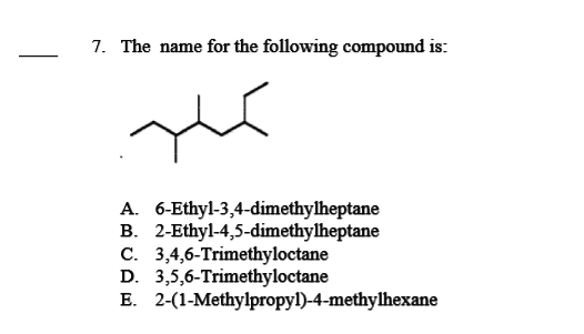

The answer is supposed to be D but I can't figure out why, my method gave me B
counting the number of points in the longest chain there are 7 and there are only single bonds so without the branches I have heptane. there is a ethyl attached to the second point and a methyl attached to the fourth and fifth point so it should be 2-ethyl-4,5-dimethylheptane
The longest chain follows the "upwards branch" and has 8 atoms.
i get it now. thank you
The correct answer is C.
woops that was a typo in the original post. The answer key has it listed as C
