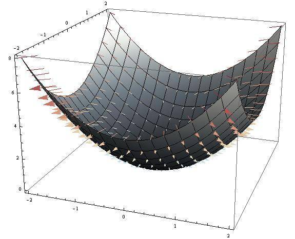

Hi,
I need to plot a vector field 2x,2y,0 which is the gradient of the function x^2+y^2. I need to plot it only in some interesting points (points on the paraboloid x^2+y^2). So I tried something like
a=Table[{{x,y,x^2+y^2},{2x,2y,0}},{x,-2,2,0.5},{y,-2,2,0.5}]
ListVectorPlot3D[a]
It did not work. The definition of ListVectorPlot3D[{{x,y,z},{a,b,c}},...] says that it generates a 3D vector plot from vector field values {a,b,c} given at specified points {x,y,z}.
Any idea how I might plot that gradient on the paraboloid ? It would be really unpleasant if I had to do every single vector with Graphics3D[]
thanks
Code:
pnts = Flatten[Table[{x, y, x^2 + y^2}, {x, -2, 2, 1/4}, {y, -2, 2, 1/4}], 1];
plv = VectorPlot3D[{2 x , 2 y, 0}, {x, -2, 2}, {y, -2, 2}, {z, 0, 8},  VectorPoints -> pnts, VectorColorFunction -> "ThermometerColors",    VectorScale -> Small];
plp = Plot3D[x^2 + y^2, {x, -2, 2}, {y, -2, 2},  ColorFunction -> "GrayTones", BoxRatios -> {3, 3, 2}];
Show[plp, plv, ImageSize -> 600]
Gives me this: It took me a bit of time, but I have always wanted to learn how to do this anyway so 30 minutes well spent.
Does anyone know how i can make the arrows START at the point rather than be centered at it?
