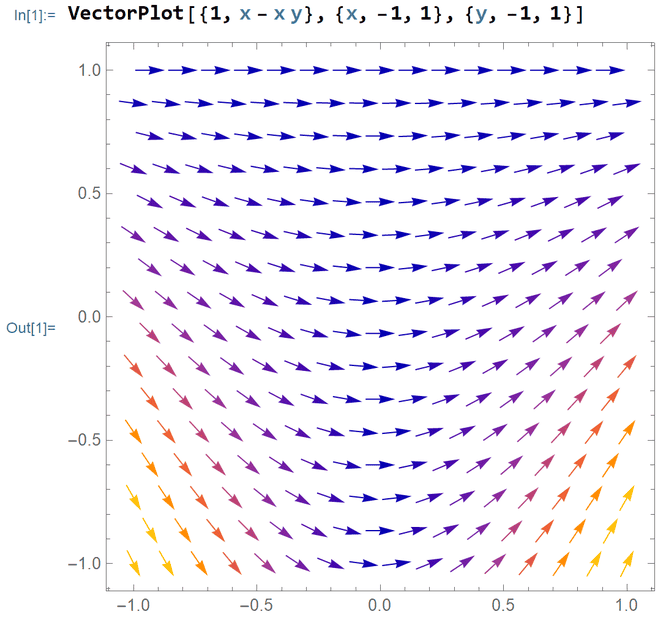

So, I'm working on ODE at this point, and unfortunately I don't have the time to learn all of the Mathematica input for at least a few months. But, I was hoping someone could tell me how to graph direction fields of ODEs, either with the Mathematica input or free-form?
Looking through the Mathematica site, it looks like VectorPlot or VectorPlot3D is one of the two commands I'd be looking to use, but the two pages I found on the site show information that went over my head. I don't know how to enter in what I'm looking to do.
Basically, I want to be able to take something like y′+xy=x, and create a graph of the direction field within a given region. I wanted to take a little time to do this for multiple equations (including some of the ones I'm seeing in the OpenCourseWare lectures), so that I can get a better idea of the general type of field for certain types of ODEs (without having to take the time to put them together myself). Any help here would be greatly appreciated.

Is this what you want?
Yes, that's the type of thing I'm looking to do. How would I go about plugging a differential equation into a vector plot like that?

Post #2 is the vector plot of the 1rst-order differential equation you gave: y′+xy=x.

Oh, ok I got you. So it automatically assumes it as an equation for y' without having to plug it into the input. Thank you, I appreciate the help

I did have one other question in regards to that input. The "1" in front of the "x - xy", is that for "first order differential", or something else?

But anyway, still not sure what the "1" in the front of the equation in VectorPlot means. What I do know is if I plug "y" in there instead of the 1, I get vectors in a circle. Looked around on the web, and I don't see anything from Mathematica that clarifies it for me.
