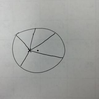

In order for me to be able to run a simulation I need to write an equation which calculates the distance from a point inside a circle of radius 'r' to any point along the circle's circumference using a point a distance 0<=d<=r from its center. The ultimate system to be simulated is a radially pre-loaded circular membrane with fixed, rigid edges that experiences a transverse deformation because of a point-force.
Imagine drawing a circle, mark a single point inside that circle, then draw several lines going from the point to different points along the circle's circumference. (For the sake of variety, I'd ask that none of the drawn lines are parallel.) The equation would be designed to tell you the length of each of those lines. It may very well be possible to write the equation for calculating the length of a chord, which uses the circle's radius and the perpendicular distance of the chord from the circle's center:
They cannot be, they all have to cross each other in one point.
How do you define your lines? You need some parameter that describes where the line is in order to calculate its length. I don't understand the "using a point a distance 0<=d<=r from its center" part. Is that a second point the line crosses?

The drawing is merely for the sake of helping to better understand the visual concept of the problem.
'd' is the distance from the circle's center, which is greater than or equal to 0 and less than or equal to r, the radius of the circle.
As I said, just for the sake of variety.
Mark the point closest to the center (extend the line if necessary). The distance from the rim to this point is half the value of your formula in post 1, the distance from your old point to the new one can be found with a right triangle. Add both (or subtract for the shorter lines) to get the total length.
