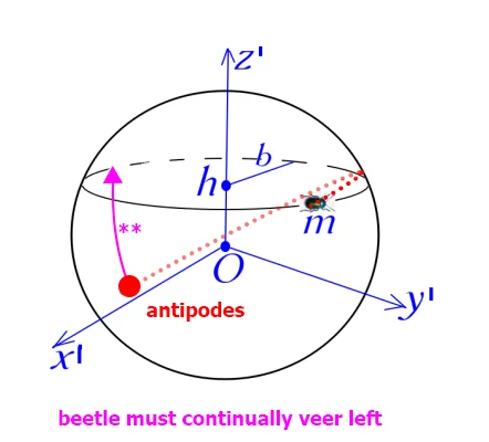

the beetle begins to crawl such that its trajectory draws a circle of radius b on the ball
Why do you say "radius b"? b is equal to R - the radius of the sphere.
The beetle can't make to sphere spin any way except on a plane that passes through the ball's centre.
The beetle's circle can be any size, up to a great circle.
The sphere will rotate about an axis that passes through the centre of the beetle's circle, and the centre of the sphere.

In order for the beetle to walk path p that is not a great circle, it would have to look like diagram A.
But why would the sphere rotate along the axis a (as seen in A's top view)
The sphere would always rotate such that the beetle's path is a great circle, no matter what.
In diagram B: beetle's path p causes sphere to rotate on axis a which is perpendicular p. Thus p will always be a great circle.
If the beetle walks a straight path it must form a great circle, and will pass through its antipodes.
To follow the path in wrobel's diagram, it must continually veer left:
(note: antipodes is on far side of the sphere, so beetle's left is toward top of diagram)
Diagram of a sphere with axes x', y', z' and centre O, showing a beetle on the surface at point m with a dotted curved path from an antipodes point, labelled b and h, with an arrow marked ** and the note beetle must continually veer left.
wrobel said:
It's a bit funny because I have equations written down and you're just saying words :)
Granted, I may be misunderstanding the problem as-written.
What causes the sphere to rotate? The beetle's movement, right?
So why does the sphere not rotate on the axis perpendicular to the line from beetle to sphere centre?
Let's remove the sphere's rotation for a moment and just examine the beetle's path on a fixed sphere.
On a fixed sphere, every straight path the beetle chooses is part of some great circle. So it goes with out saying that the beetle is always walking a great circle. How could it be otherwise?
As with Baluncore, above: in your diagram the beetle is following a curved path. It must constantly correct, turning continually left, to maintain that path.
If the beetle were to walk a straight line - any straight line - around the sphere, it would pass through the antipodes, right?
But you have your beetle not passing through the antipodes.
Diagram of a sphere with axes x', y', z' and centre O, showing a beetle at point m on the surface, a circle of radius b at height h, a red antipodes point, and a dotted path with an arrow marked beetle must continually veer left.
You have it veering off a straight path that puts it about 30 degrees off straight by the time it's crossed half the sphere.

He says it isn't required to be a great circle so the path isn't required to be straight. The idea could be that the insect's path is the same as if one were to have drawn a circle on the sphere and the insect followed that path. In this case I think an outside observer would not see the path as a circle. Or maybe he means that an outside observer would see the path as a circle but an observer fixed to the surface would not. He said the insect returns to it's original location so I guess it is the first condition.
The angular velocity of the ball changes its direction relative to the ball-fixed frame (see the text attached) and thus it changes its direction relative to the lab frame. Thus, there is no fixed axis about which the ball rotates.
