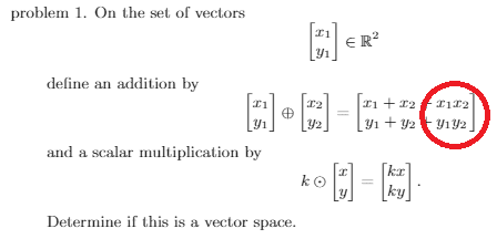

OK from the text bk I did not see any example of this
the circle red is mine ... why is this here
so not sure how these questions are to be answered.
Much Mahalo
Which textbook are you using? Are you sure it does not contain solved similar examples?
By definition. The author (or anybody) has the right to define whatever concepts they like.
The problem asks whether this is a vector space. Do you know the definition of a vector space?
One condition is that a vector space have a 0 vector. That means that there exist a vector 0 such that v+ 0= v for every vector v. Here it is clear that \begin{bmatrix}0 \\ 0 \end{bmatrix} is that 0 vector.
Another condition is that every vector has a "negative". That is, given a vector v, there exist a vector u such that u+ v= v+ u= 0.
Here that means that, given v= \begin{bmatrix}x_1 \\ x_2 \end{bmatrix}, there exist a vector u= \begin{bmatrix}x_2 \\ y_2 \end{bmatrix} such that u+ v= \begin{bmatrix}x_1+ x_2+ x_1x_2 \\ y_1+ y_2+ y_1y_2\end{bmatrix}= \begin{bmatrix}0 \\ 0 \end{bmatrix}
So the question is, given numbers x_1, y_2, can we solve the equations x_1+ x_2+ x_1x_2= 0 and y_1+ y_2+ y_1y_2= 0 for x_1 and x_2? We can write the first equation x_1= -(x_2+ x_1_2)= -x_2(1+ x_1) and then x_2= -\frac{x_1}{1+ x_1}. What if x_1= -1?
