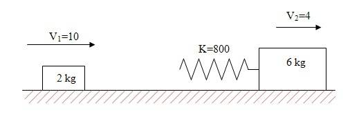

2 masses moving on a friction less surface. one of 2 kg moving at a speed of 10 and one of 6 kg moving at the speed of 4. at the back of the heavier one is a spring with a constant k=800.
What is the maximum shortening of the spring
Conservation of momentum: [itex]m_1v_1+m_2v_2=m_1u_1+m_2u_2[/itex]
Conservation of energy: [itex]\frac{1}{2}mv^2=mgh[/itex]
Elastic energy in s spring: [itex]E=\frac{1}{2}kx^2[/itex]
At the maximum shortening the velocities are equal:
[tex]\frac{1}{2}\cdot 2 \cdot 100=\frac{1}{2}\cdot 800 \cdot x^2+\frac{1}{2}\cdot 8 \cdot u^2[/tex]
[tex]2 \cdot 10=8 \cdot u[/tex]
Those give x=0.43 while it should be 0.259

6 kg block is in motion .You have not considered its kinetic energy.
Same mistake .You have not included momentum of the 6 kg block.

I took in consideration the 6 kg block in both cases. the number 8 in the kinetic energy and the momentum equation is (2+6)
You have incorrectly presumed that 6 kg block is initially stationary .Look carefully in the picture .The 6 kg block is moving with 4m/s before the 2 kg block comes in contact with the spring.
Include the momentum of 6 kg block in the initial momentum i.e in the left hand side .Same with energy conservation .

Items in red are incorrect.
Equations
##\frac{1}{2}m_1v_1^2+\frac{1}{2}m_2v_2^2=\frac{1}{2}kx^2+\frac{1}{2}(m_1+m_2)u^2##
##\Rightarrow \frac{1}{2}\cdot 2 \cdot 100+\frac{1}{2}\cdot 6 \cdot 16=\frac{1}{2}\cdot 800 \cdot x^2+\frac{1}{2}\cdot 8 \cdot u^2 ##
##m_1v_1+m_2v_2=(m_1+m_2)u##
##\Rightarrow 2 \cdot 10 +4 \cdot 6=8 \cdot u \rightarrow u=6##
They give x=0.1, wrong
Karol said:
##\Rightarrow 2 \cdot 10 +4 \cdot 6=8 \cdot u \rightarrow ## u=6
Be careful with your calculations .## u = \frac{44}{8} ≠ 6##
