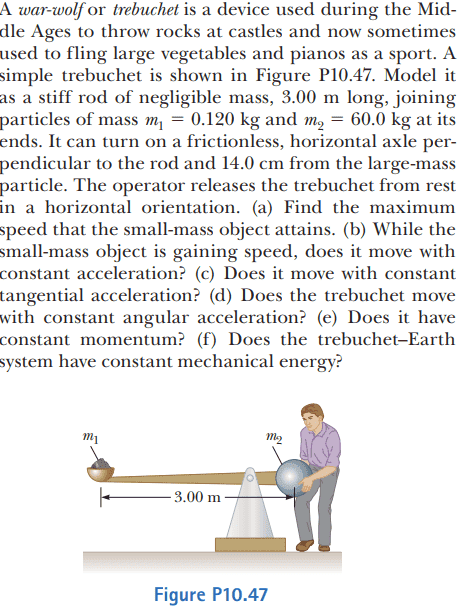

For this problem,
For part(a) the solution is,

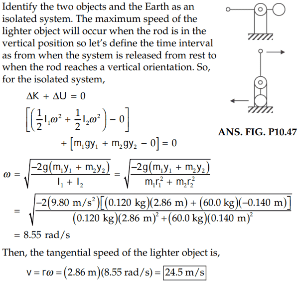

However, how did they know that the max speed is reached in the vertical position?
For part (d) the solution is,
However, I thought the solution would be because there is net gravitational torque in clockwise direction (torque due to small mass – torque due big mass) then angular momentum is not conserved.
I don’t understand why they talk only about the lever arm of the 60 kg mass, as there is also a lever arm for the smaller mass. I agree thought about their statement that the lever arm due to the masses on each end changes as the war-wolf rotates.
Many thanks!
I don't see mention of a lever arm in the extracts you posted.
Yes, each weight has its lever arm.
Before it reaches vertical, is the system getting faster or slower?
What about after vertical?
Thank you for your reply @haruspex !
The system is getting faster I think because the system as a whole is losing gravitational potential energy (big mass losing GPE at a faster rate than GPE gain by small mass - even though they have same tangential speed)
Many thanks!

And what about after passing the vertical position?
I think it slows down since the big mass starts gaining GPE
Many thanks!
Many thanks!
Right again.
If it accelerates all the while before reaching vertical and decelerates thereafter, when is it rotating fastest?

Thank you for your reply @haruspex!
As the war wolf passes the top there is a moment where there is only centripetal acceleration and no tangential acceleration since the war wolf is parallel to gravity. However, since it is still rotating it makes at angle ##d\theta## with the vertical so it has a tangential acceleration again that increases. I guess I could of just said that the top is at unstable equilibrium.
If I reason from mechanical energy conservation, then the system has the least amount of potential energy when the little mass it at the top and the big mass is from the bottom. Therefore, as there is no non-conservative forces acting then the system must have the largest rotational kinetic energy.
Many thanks!
Callumnc1 said:
However, since it is still rotating it makes at angle dθ with the vertical so it has a tangential acceleration again that increases.
I can't follow your reasoning there. You accepted it accelerates until vertical and decelerates thereafter. So when is it rotating fastest? It's a simple enough deduction.
Yes, that's another way to get there.

Callumnc1 said:
Sorry I think I was meant to say that before it reaches the vertical it is deaccelerating and after it reach's it is accelerating (tangentially).
Eh? I already agreed with you it is the other way: accelerating until vertical, decelerating thereafter. I am asking what tells you about where it reaches maximum speed.
Yes sorry, I agree that it accelerates until vertical an deaccelerates thereafter. The reason it reaches max speed at the vertical is because it keeps accelerating until its reach's the vertical and deaccelerates afterwards. The acceleration = 0 at the vertical.
I think we could also integrate the acceleration graph to find that the velocity is max at the vertical.
