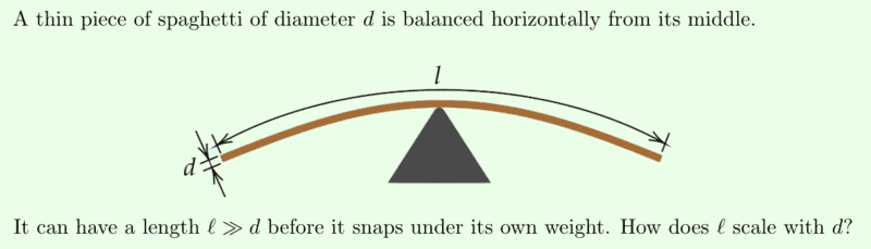

TL;DR Summary: A thin piece of spaghetti of diameter d is balanced horizontally from its middle.
It can have a length ℓ ≫ d before it snaps under its own weight. How does ℓ scale with d?
Diagram of a thin spaghetti rod balanced on a dark triangular pivot at its middle, drooping at both ends. Labelled half-length l across the span and diameter d at the left end.
Let the spaghetti rod have density ρ, and consider ONLY its right half.
(1) The spaghetti rod experiences some horizontal stress, let it be ##\sigma##. By taking moments about the pivot point, moment due to weight must be balanced by moments due to the horizontal stress. Therefore,
##\rho d^2 l (l) \sim \sigma d^2 (d)##, so ##\sigma \sim \rho \frac {l^2} {d}##.
This agrees with the textbook solution.
However, the text makes an additional remark that:
(2) There must be a vertical normal force (at the pivot) ##F \sim ρd^2ℓ## to balance the weight. This vertical force is transmitted through the rod by a shear stress (i.e. an internal force per area, perpendicular to the rod) of order ##σ_v## ∼ F/A ∼ ρℓ.
It then compares the 2 stresses, and concludes that: Horizontal stress is much greater than ##σ_v##, because of the miserably small lever arm, which is why thin rods usually break by snapping, not by shearing or pulling apart.
How did it reach this conclusion? I get that horizontal stress is much larger than vertical stress, but how does that lead to the claim that thin rods are more likely to break by snapping?
Doesn't it depends on the maximum horizontal and vertical stress for the material?

I see, then the ratio of tensile to shear stress in the spaghetti rod would far exceed 2:1 (generally), since ##l >> d##. However, could you further explain why "thin rods usually break by snapping, not by shearing or pulling apart". Shouldn't a larger tensile stress cause it to pull apart instead of snap?
Those are three different types of external loads, which are "felt" very differently by the same cross section.
Bending is always the king of destructive loads, mainly because it involves leverage-moments that other loads don't.
Once the area farther from the neutral axis starts separating, the cross-section area rapidly decreases, increasing the value of the internal tension stress (hence the snapping effect).
