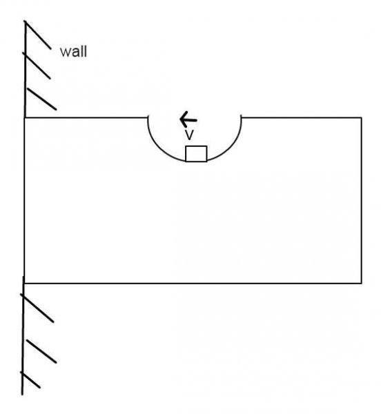

My teacher says velocity of the wedge will be maximum at the below instant
I am not getting why?As can be seen from the image no net force is acting on thee wedge at this instant.Because the only force acting is in vertical direction which is balanced by normal force.I think velocity of the wedge should be maximum at
As in this the only force acting is in horizontal so maximum force ,maximum acceleration hence maximum velocity.

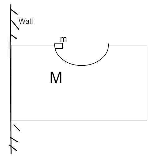

1. Homework Statement :There is a wedge of mass kept on smooth surface. M and block of mass m is sliding in the depression of the wedge.And there is wall in left of the wedge.At which instant velocity of the wedge will be maximum?(surface of contact between wedge and block is smooth)
https://physicsforums-bernhardtmediall.netdna-ssl.com/data/attachments/64/64652-5de495f229ba4bd42a727d2570e0f6fc.jpg
2. Homework Equations
https://physicsforums-bernhardtmediall.netdna-ssl.com/data/attachments/64/64654-a429551536e8d18cafe546da0c38a3dd.jpg
But the horizontal component of normal force is balanced by the wall reaction and vertical force is balanced by normal reaction on wedge .So no motion of wedge.So
conservation of energy as no dissipative force is there.
blocks potential energy is converted into it's kinetic energy completely.
3. The Attempt at a Solution :
https://physicsforums-bernhardtmediall.netdna-ssl.com/data/attachments/64/64659-5168d6ca9d612915662a0111d957a41e.jpg
When the block reaches at height h
as in the below image(I forgot to specify height "h"in my picture.) the block maximum height in right hand side is "h" ,Vertical force is still balanced but horizontal force is not balanced by any force as wall is not on right hand side.
So block accelerate.Now the block kinetic energy at mid point let's say 1/2 mv^2 of the depression is not completely converted to it's potential energy.As some goes in kinetic energy of the wedge.
https://physicsforums-bernhardtmediall.netdna-ssl.com/data/attachments/64/64656-7d13d77e1bad91857f1a6f7eca50d4bb.jpg

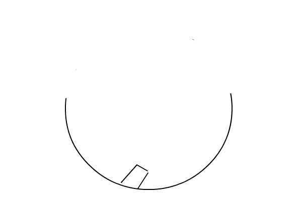

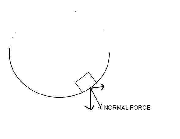

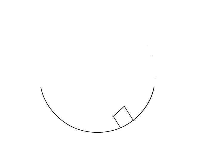

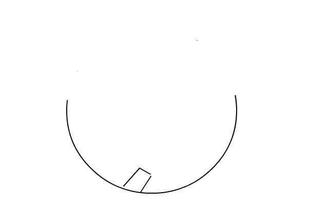

A moment before the situation shown, where was the block in relation to the wedge? What direction would have been its force on the wedge? Which way would the wedge have been accelerating?
Same questions for a moment after the position shown.
haruspex said:
Which way would the wedge have been accelarting?
In the right direction.
Right. So had it reached max speed then?
What about the situation a moment after that in the diagram?

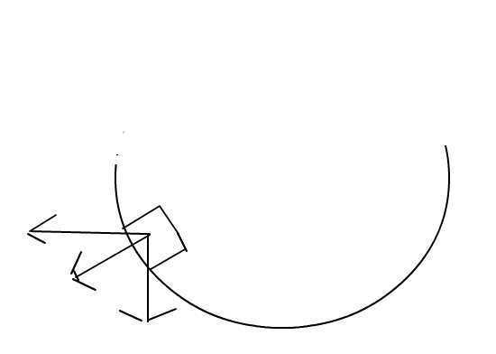

In your teacher's diagram, the block is at the midpoint of the depression and moving left relative to the wedge. Where will it be relative to the wedge a moment later? What direction will its force on the wedge be?
One Component of normal force on wedge by block is In the left direction but it will be balanced by normal force by wall and the ground balances the other component of normal force on wedge by block.
In the position in your teacher's diagram, it is no longer in contact with the wall.
Yes. I got your point .Wedge is no longer in contact with the wall,because the wedge has moved further.
In the left direction, so it will decelerate the wedge.

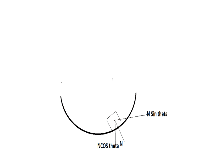

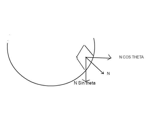

Actually I am not getting what this theta (angle) is?Is horizontal component Nsin theta or N cos theta?

As long as the block is to the right of the midpoint of the depression, it is exerting a force to the right on the wedge. So the wedge is accelerating to the right, and is at less than its maximum speed. Maximum speed occurs when acceleration is zero.

gracy said:
I wanted to ask is the force which causes acceleration of wedge varies as the block moves ?
Not sure I understand the question. The force causing the acceleration of the wedge is the horizontal component of the normal force between block and wedge. That varies, of course.
Why?Because theta changes?
Yes, and also because the normal force changes.
