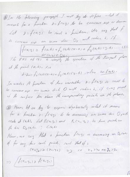

Hi all,
In my Calculus III course, we are using Stewart's book, so as you might know there is not much rigor in there.
Likewise, when it came to the section on Maximum and Minimum values of a function with two variables z=f(x,y), they ommited a lot of stuff.
Hence, i tried to use simmilar ideas as in single variable calculus, to derive some of the theorems and also tried to prove them as well concerning some topics.

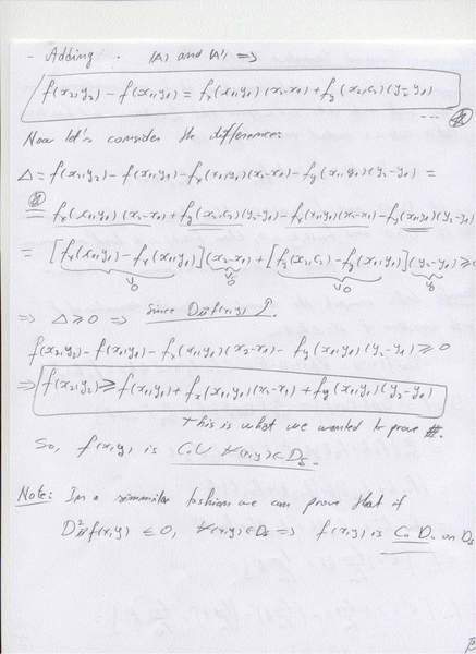

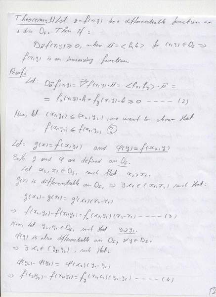

Specifically, i started out by first trying to define what it means for a function of two variables to be concace up or down, then moved on trying to establish a theorem(equivalent to single-variable calc) that says if the first derivative is >0,<0 then the function is increasinng/decreasing respectively. But in this case, i used the idea of directional derivatives.

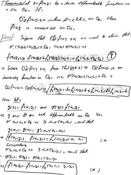

And then moved on to constructing another theorem that says if the second directional derivative of f is >0 then the function is C.U.(again here, extrapolating from single-variable calculus).
The statements of these theorems and their proofs are attached.
Bear in mind, i have never seen anywhere neither these theorems nor their proofs, i just tired to extrapolate from single-variable calculus, so my question is do they make any sense? I mean are they mathematically correct?
All the best!

Here are the next two pages!

In your "proof" for an increasing function, what is the vector u=<h,k>? What direction is it in? A differentiable function, f, will have Duf(a,b) ranging from -M to M depending on the direction of u, where M is the magnitude of the gradient of f at (a,b). So to say Duf(a,b) is greater than zero is false if we are allowing ANY direction u with a differentiable function f whose gradient is not 0.
Also, the notion of "increasing" for f(x,y) is unclear.
For example, is the function f(x,y) = x + y increasing?

There is still a problem with “increasing” for multivariable functions. Try this out:
Can you find a non-horizontal plane z = Ax + By that you would consider to be “increasing”?
Also, about that function being increasing...
f(x,y)=x+y
Using this definition “x1 < x2 OR y1 < y2” => f(x1,y1) < f(x2,y2)
But look at
(3, 5) and (4, -20)
Then, “3<4 OR 5<-20” is true but f(3,5)=8 > f(4,-20)=-16

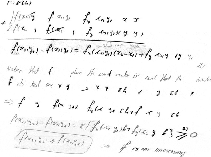

So how would one prove that if Duf(x,y)>0 where u=<h,k> then f(x,y) is an increasing function at least in the direction of u.?
I tried to do it, but i see that there actually is another 'flaw' in my 'proof'. And i couldn't fix it.

As far as I can tell "concave up" was only defined for 1-dimensional functions. Without a definition for concave up, there is nothing to prove.
Of course, a natural definition for concave up in 2 dimensions would be that all points on the function are greater than or equal to the tangent plane at that point. This definition is equivalent to saying that the class of 1-dimensional functions generated by taking a slice out of the two dimensional function are all concave up. Since a proof for one dimensional functions was already given, there would be nothing to re-derive, because it already generalizes to 2 dimensions given this intuitive definition for concave up.
The concept of monotonically increasing or decreasing is inherently one-dimensional, and has no multi-dimensional analog.
If you're more interested in the geometry of surfaces I suggest you take a course in differential geometry. The concepts of umbilical points, the shape operator, Gaussian curvature, etc, are all related.

This is exactly how i 'defined' concave up in my first post( the pages scanned).
When you say that "Since a proof for one dimensional functions was already given, there would be nothing to re-derive, because it already generalizes to 2 dimensions given this intuitive definition for concave up." How come there is nothing to derive?
It looks to me that more than simply an intuitive understanding is needed. I.E. i think that a rigorous proof needs to be derived. However, the problem that i see here is that in order to derive a rigorous proof for concavity of two variable functions, we need to have a handle of monotonicity of two variable functions.And this is exactly what i am failing to overcome.

Ok, let me break it down then:
1) You agreed with me on the definition for concave up of a 2-dimensional function; namely, that the function is greater at all points than the tangent plane.
2) For any point on the 2-dimensional function, there is a corresponding 1-dimensional slice that yields a 1-dimensional function passing through that point.
3) For all 1-dimensional slices, the existing definition can be used to prove that the one-dimensional function is concave up.
4) If all 1-dimensional slices are concave up, and all points on the two-dimensional function are contained within one of the slices, then this is sufficient to define the 2-dimensional case for concave up.
Also, you actually can generalize the notion of "increasing" (from the first derivative) to 2-dimensions (it's just not particularly useful). An increasing function in one dimensions was one that has a positive derivative (in the direction of X). An increasing function in 2-dimensions could be taken as one that has a positive directional derivative in any direction that is in the first quadrant.

Increasing Test
If [tex]\nabla_v f(x,y) > 0[/tex] on an interval, for any constant vector v, then f is increasing on that interval in the direction of v.
Define [tex]g(t)[/tex] to be the value of [tex]f(x,y)[/tex] starting at [tex](0,0)[/tex] in the direction of [tex]u = (h,k)[/tex]. Then [tex]g(t) = f(h t,k t)[/tex]. By definition of the directional derivative, we have [tex]\nabla_v f(x,y) = g'(t)[/tex]. From the 1-dimensional increasing test, if [tex]g'(t) > 0[/tex] on an interval then [tex]g[/tex] is an increasing function on that interval -- which is what we originally wanted to prove.

Hi junglebeast,
I was trying simmilar approaches, that is i also tried to define a function g in tems of f, in a simmilar fashion, but as i previously admitted, somehow i couldn't manage to take into account only points (x,y) that lie on the line that contains the direction vector u=<h,k>, but now i see where i was going wrong.
Just to make sure that i am not missing, or misinterpreting something, i will try to 'restate'(with a few changes)the whole steps in the proof, so i hope you are not bored.
Proof:
Let:
[tex]D_uf(x,y)=f_x(x,y)h+f_y(x,y)k>0[/tex] where u=<h,k>, for (x,y) in some disc B.
Now, let [tex](x_o,y_o)[/tex] be the coordinates of the tail of the vector u.
Now, let (x,y) be any other point in the curve C, which is obtained when we cut the surface S with a plane that contains u, and is parallel with the z-axis.
This way if we let: [tex]P(x,y)...and ... P_o(x_o,y_o)[/tex] we get
[tex]P_oP=tu=<th,tk>[/tex]
From here, we can see that:
[tex]x(t)=x_o+th...and...y(t)=y_o+tk[/tex]
Now, since we are interested only what happens with f(x,y), when (x,y) lie on the line that contains the vector u, from above we get:
f(x(t),y(t)). Hence we can define a function g(t) in this manner;
g(t)=f(x(t),y(t)). =>
[tex]g'(t)=f_x(x(t),y(t))h+f_y(x(t),y(t))k>0[/tex].
Hence, from the theory of functions of single variable we conclude that since g'(t)>0=> g(t)=f(x(t),y(t)) is an increasing function on the direction of u.
