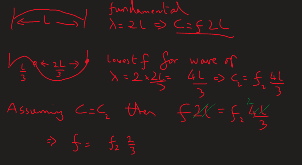

The fundamental frequency f is the lowest frequency heard when a stretched string is vibrating.
The string is now lightly touched one third of the way along its length.
What is the lowest frequency heard?
The answer seems to be 3f - but I cannot get that.
speed = freq x wavelength
Here's my working. Perhaps I make some wrong assumptions?
Handwritten red notes on a black background: a string of length L fixed at both ends in its fundamental mode with lambda = 2L and c = f 2L; a second sketch with a node at L/3 and length 2L/3, giving lambda = 4L/3 and c = f2 4L/3; and the equation f 2L = f2 4L/3, leading to f = f2 (2/3).
Your reasoning is not clear to me. Also, what does "lightly touched" mean? Is it supposed to imply that the string needs to have a node there? (Note that the wave with wavelength 4L/3 does not have a node at one of the ends.
well, I read it as being a node at the point at the point where it is touched
Is there any frequency with wavelength 4L/3 for the string of length L?

that is how i read it. so string vibrates in two sections one of lenth 2L/3 and one L/3
No, that is not what he said. That would be holding the string firmly at L/3.

@maxelcat, the point is that if you touch the string lightly at a position ##L/3##, then the string continues to oscillate "as a whole", i.e. the new lowest frequency of oscillation (say ##f'##) is the same for all points on the string. You are essentially just imposing the condition that the string, of length ##L##, has a node at position ##L/3##. Have a look at case 5 in the image I linked to in post #4; it should then be clear why ##f' = 3f##!
This is not the same as pressing firmly, which would result in the two sides of the string becoming independent of each other (effectively, you'd instead have two separate, shorter strings).

Yes - I can see that. I misunderstood what it meant about 'lightly'. Thanks all. (BTW this is an AS level q so it shouldn't be hard!)

No, you just have the wrong interpretation. The entire idea of being touched lightly is to force the string, as a whole, into an oscillation that has a node point at L/3.
