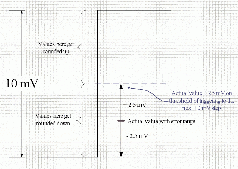

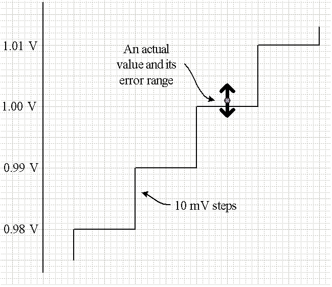

Sketch one step of the ADC's "stairstep" transfer function (a 10 mV jump between output values). Imagine that a measured value falls somewhere in that range so that the when the ADC does the conversion it must round either up or down to the nearest 10 mV level. But the input value has an error of +/- 2.5 mV associated with it, so for a given actual value it could fall anywhere within a spread of values on the sketch. Find the worst case scenario for the difference between the actual value and the "measured" value.

Picture a staircase with a slope of 45 degrees. Each step has a height of 10 mV. Each level corresponds to one of the 28 possible outputs of the ADC.
But anyways why don't we just write 10mv - 2.5 mv as the measured value for the worst case scenario then? As for the actual value I don't know what it is as its not given in the question.
You don't need a particular actual value. You propose some value that will fall somewhere in the ADC's input range. A particular input value isn't important. It's the fact that any input value will be rounded to the nearest 10 mV level.
So yes, 10 mV - 2.5 mV sounds like a reasonable worst-case scenario:

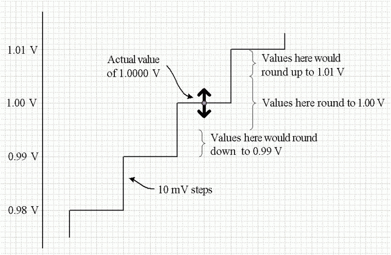

Can you sketch a situation where an input would lead to a 12.5 mV difference? Remember, the ADC will round to the nearest 10 mV level.
so you mean because the resolution of the ADC is 10 mV the difference can't be higher than 10mV but lower than it?
Yes, since the possible error in the input value is less than half a step size. There's no input value that would put its error range more than a half-step away, which is what would be required to jump a whole 10 mV away:
Slide the actual value and its error range up and down on the stairstep and see what values the extremes of the error range would round to.

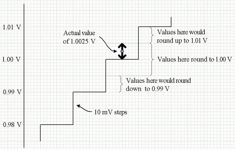

well let's say at 1 V. For the upper part will it be 1.0025 V? which will be rounded to 1.003? and for the down part it will be 0.9975 so will be rounded to 0.998?

10 mV is 0.01 V. So you get two decimal digits in any rounded result. Both of those values would round to 1.00 V, the nearest step.

Take another look at the image in post #12. If that actual value is nudged upwards just a tiny, tiny bit, what will be the difference between the actual value and the value reported by the ADC if the error happens to be at the top of its range?
it gets triggered to the next 10 mV step. The difference will be the actual value + 2.5 mv error - actual value. right?
No, it will be the step value that is reported minus the actual value (well, technically its the difference between the actual value and reported value. The same situation could be set up for the bottom of the error range of the value, resulting in a rounding down to the next lower step).

So in the diagram if the actual value is 1.00 V then what's its reported step value?
What's the nearest 10 mV step to 1.00 V + 2.5 mV or 1.00 V - 2.5 mV?

Place your actual value on the stair diagram and check where the ends of the error range fall.
Note that the top of the error range just touches the level where the ADC would choose to round upwards to 1.01 V. Since error ranges are not hard values, there is a possibility that your 1 V + 2.5 mV = 1.0025 V actual value could be reported as 1.01 V. That would make the difference between actual and reported value 7.5 mV, correct?
That is if you are going upwards. What if you are going downwards for the error? Then it just gets round to 1 and difference is 2.5 mV.
