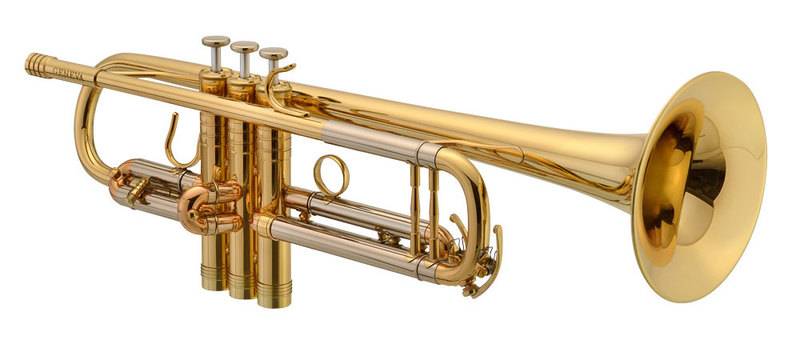

What about accumulating energy over time? Into a constrained standing wave? The shape of a trumpet comes to mind. Operating in reverse.

A trumpet doesn't concentrate sound energy - just the reverse. Only ~1% of the energy "leaks" out the bell - there is an enormous impedance mismatch between the inside and outside of the horn.

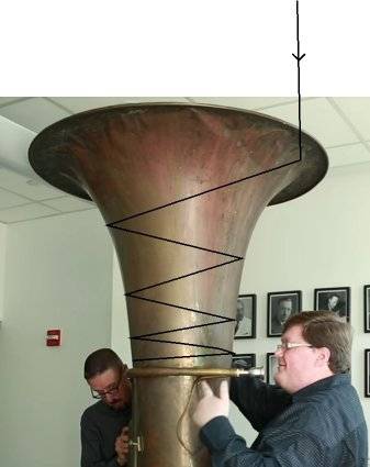

I reckon the following path of sound is plausible. To create strong standing waves. Maybe with a little reshaping - nice math problem: what is the equation of the optimal curve that does this? Could try an exponential curve and see what happens. Or a piece of a parabola.

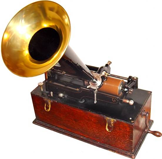

Sound - no. But the energy and force - well, yes. Cylinder phonographs (the ones which could record too) did exactly that, for example.

At low frequencies the horn generates a spherical wave, axial with the horn. The spherical wave front is guided by and remains perpendicular with the surface of the horn as it expands. Reversing the process; where will you get an inside-out spherical wave to concentrate in the horn? Maybe you could use a lens made from a slow wave material such as a spherical balloon full of a heavy gas such as CO2.
If you have a plane wave things will be easier as you can use a parabolic reflector for both the transmit and the receive.
Maybe you should read more about the subject before you risk confusing yourself by leaping to wrong conclusions.

I think the sound comes from the vibrating metal of the entire instrument, not something at the mouth of the musician. Maybe another shape is optimal for accumulating energy over time. Just like you can hit a lever and break something much stronger than your hand, same seems feasible with sound waves. This is exactly the principle of Edison's phonograph. But how do you scale it up to break stones?

- mechanical amplification/focusing. The already mentioned cylinder phonographs are doing just this: through a membrane and a needle they can focus the power of the incoming sound waves to a very small area (tip of the needle). Usually, sound waves has very little energy, barely enough to make some marks on the wax cylinder. But maybe some big drum-like thing, with a chisel on one side and with some really heavy drumstick on the other...
