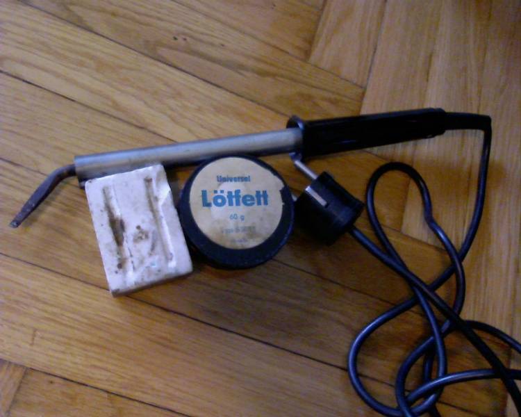

I am very new to electronics and only use it as a hobby. My father bought the soldering iron, but never used it. Manufactured in East Germany (DDR). It came with some kind of a "dark cream" and a white thingy - I do not know what are those for. I have started to look at videos on Youtube "how to solder". Is it safe to plug this in after 30 years? It was stored in our garage in a cool and dry place.Additional info:
On the package it says: "Delta Lit-Box"
On the iron it says: TYP623, 220V, 60W and a sign in a circle that has two parts (an "I" on the left and a "T" on the right which is rotated 90 degrees towards the "I"
On the dark creme box it says "Universal Lötfett" Typ SW13 , IV-14-14
Regarding 220V - I live in Europe - we have 220V

If your Dad used it safely at your current residence, it probably is okay. Learn about safety BEFORE you play with it. If there is some solder left around from the old days, it probably is lead based. Consider buying a new spool of solder that is less lead-laden. I am guessing the round container has soldering flux. Hopefully the videos you see will explain what it is and why you need to use it. Some solder you can buy nowdays has a flux core.
And. Thanks for asking first. Eyes and fingers are hard to replace.

You probably want ot get a holder for the soldering iron, or make one. Just something to keep it raised in the air and isolated from materials that might burn (your fingers, wood, paper, etc. WHen it is active you don't want to lay it on its side like in your picture.

The bit is in bad condition . Appears to have been eroded and lost it's plating . For occasional use you can file it back to shape and tin but for any regular use best to get a new bit .
Personally I prefer straight bits for most small work .
I have a 40W Weller that is nearly as old as that, still going strong.
As long as the Earth pin on the plug is continuous with (connected to) the metal parts of the iron I can't see any good reason not to use it. The creamy stuff is flux. Give the bit a scrub with wire wool or sandpaper, then allow to heat up and dip in the flux. Melt some fresh solder over the end and tap off the excess ("tinning"). It should work very well like this. I agree that a straight bit and a stand would be good ideas.
I have to disagree with Jim above and recommend lead-based solder. It just performs much better. As long as you wash your hands after use, as you would if handling lead items for fishing, shooting, roofing, etc it should be perfectly safe.
Agreed. Not being familiar with European power systems, I can not tell if the plug is polarized, has a Grounding pin, or is a plain 2-prong plug. If the metal parts of the iron are NOT grounded, do not use it on any semiconductor electronic devices, there is the potential to destroy them.

If it was operational 30 years ago it should still be. Since the early 1970s I've had what was an already ancient Western Electric soldering iron. It is too huge for most electronics (about 16 inches long, overall, with a 1/4" chisel tip), but it works a treat for steel chassis connections.
A green Scotch BriteTM pad works in lieu of wire wool provided you don't tarry too long in one place, and melt the polypropylene binder. Many modern tips are plated, so use a fine grit abrasive and don't go crazy (and definitely, avoid attacking it with a steel file).
If the tip is very badly oxidized it may take a long time to recondition using only rosin flux. Ammonium chloride and/or zinc chloride plumber's flux are more effective in this circumstance, but be sure to thoroughly remove it after the tip becomes "tinnable" again by washing it over seven or more rosin flux cleaning and retinning cycles. Chloride fluxes tends to leave a corrosive residue that forms electrolytic cells within solder joints, and wreak all manner of diagnostic havoc down the road.

trickybilly: That soldering iron almost looks new. Some of mine are older than me and I'm 58. I'm still using a tin of flux that looks like this one from the 1960s/70s.

I recommend you find or make some sort of stand or hook for it. A common issue with soldering irons is that the electrical wire is or gets stiff and tends to move the iron about.
