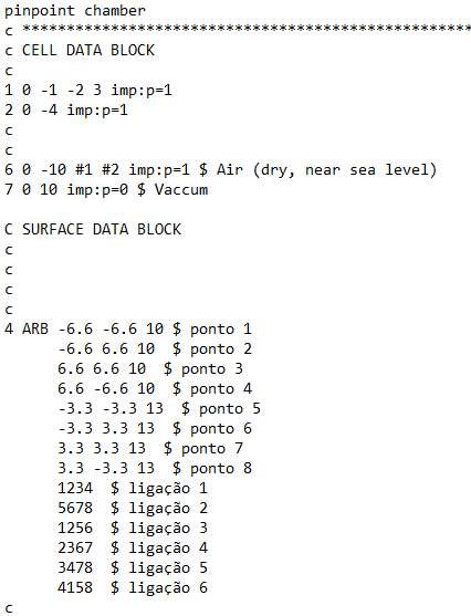

I try to build this geometry in mcnp, but I'm having difficulties. Can anyone help me? I'm having a lot of trouble defining these curves. A small introduction will help me a lot.

no, sorry. Do I put everything in just one cell?

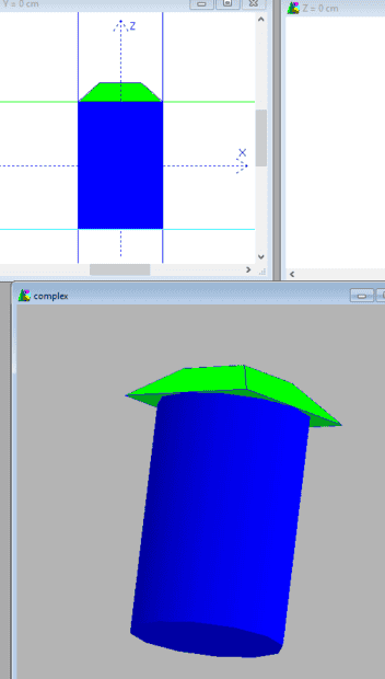

my biggest problem is this curve.

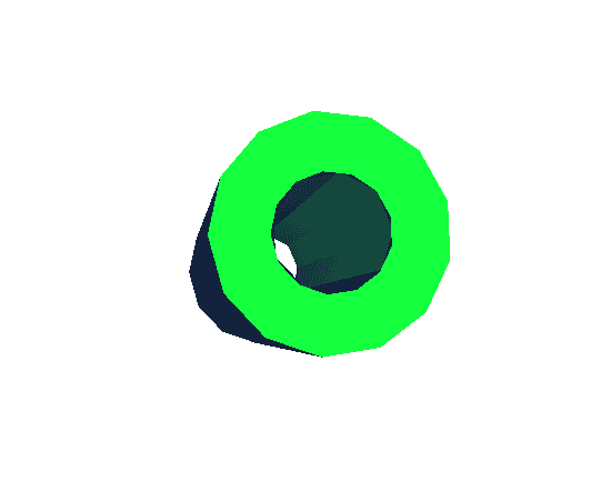

When I add two cylinders, it looks like this.
Depends what this is for, the 3cm thick outside shell seems to need to be one material, so that could be one cell.
Your dimensions seem to be off, are you putting diameter numbers into the radius? Show us your cell and surface definitions.

I tried this, maybe I'm going the wrong way, but I'm trying to join these two surfaces to make the curve on the inside.
I'm not using Vised so our approaches may be very different.

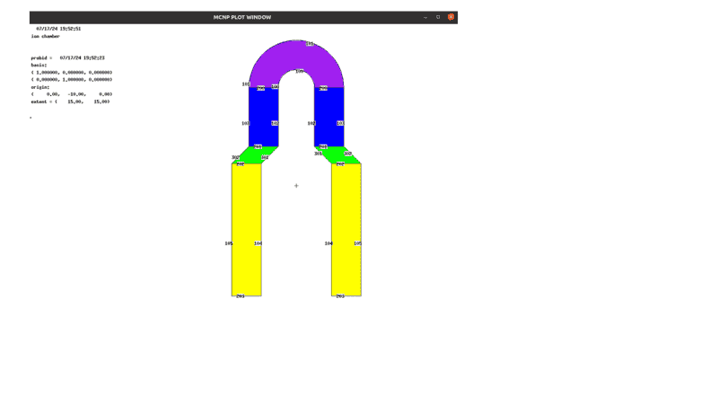

The diagram has rotational symmetry, so I would try to construct it out of spheres, cylinders and cones. The diagram is missing some dimensions so some of the following is calculated and some has been guessed.
The purple section is made from spheres, blue and yellow sections are cylinders, green section is cones.
A cylinder is easy to join to a sphere at the full width, the cone is a bit more complicated. Every join uses a py plane surface. I've used a 1/1 angle, because it looks about right. It also makes the geometry maths easier. Every 1cm along the axis the cone is 1cm closer or further away. The inner cone needs to come in by 1.85cm so the point of the cone is 1.85cm higher up than the join point. -6cm + 1.85cm = -4.15
The inner cone needs to widen to meet the inner cylinder lower down. That has a radius of 3.6, from the other cylinder of radius 1.85. 3.6-1.85=1.75 and with an angle of 1/1 the height of the cone section is then also 1.75
The other cone section maths produces the same result. This shoulder looks a little thin, and could be improved by adding a band which would make it match the diagram better, but I'm not going to do that.
If the shaded area is needed as a single cell that can be done by a union of all the pieces. Because it is so long it needs to span more than one line. For example
Code:
2 2 0.001 (200 -101 100):(-200 201 -103 102):
     (-201 202 301 -302):(-202 203 104 -105)
This is just the shaded outer part. Other structures are needed, most can be defined with the existing surfaces, but you may need to add another plane and a cylinder or two. You may also need to correct my guesses as to the cylinder section lengths if you have actual measurements.
If you use this or you don't use this good luck either way!
Edit, I will just add that given this is a pinpoint ion chamber it probably makes more sense that the dimensions are in millimeters not centimeters. In which case all distances should be divided by 10.
