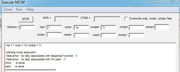

Hello everyone,
I do need your help in this matter, please kindly help me solve this problem
I use MCNP5 and i run a simple example using Fmesh4 and Fm, De / Df but I get an error:
" fatal error. no tally associated with response function -1"
" fatal error. no tally associated with fm card -1 "
Screenshot of the Execute MCNP window showing the input fields and a log with the fatal error messages 'no tally associated with response function -1' and 'no tally associated with fm card -1'.
If I remove Fm and De / Df or replace Fmesh4 by F4 then there is no error.
Thank you!

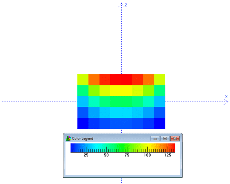

Hi,
there are small problems in your file,
but if you revise the file it gives that :
Colour contour plot of a rectangular mesh tally on x-z axes, hotter red at top centre fading to cooler blue at bottom, with a colour legend scale from about 25 to 125.
The problem comes wth the SDEF definition you forgetted the "5 spaces" after:
vec, axs, ara, dir, rad, erg
I put my file which is ok with MCNP6 and Moritz,
hope it helps,
PSR
PSRB191921 said:
Hi,
hope it helps,
PSR
Thank you very much.
I run your file with MCNP5 but still error, maybe MCNP5 can not use Fm, De / Df with Fmesh. Is there any way to be able to calculate Tally F4 the same as using Fmesh?
MCNP6 has been upgraded a lot, unfortunately my university does not have MCNP6, only MCNP5
Hi,
I tried my file with MCNP5 and it's ok (see attached file) .
It's non ok with MCNPX.
When I look at your first post, it seams that you run MCNP with "vised". Probably "vised" runs MCNPX and not MCNP5. For that read your output file (ASCII file not with vised) and look the first lines: you can know what version of MCNP runs.
PSR
Hi,
Now I understand. MCNP5 v1.6 can do that.
How to get it ...? Real headache
thank you very much
Haha, success!
I copied the input file to the MCNP VisEd folder (bin folder), and run MCNP5 from CMD
Thanks everyone
