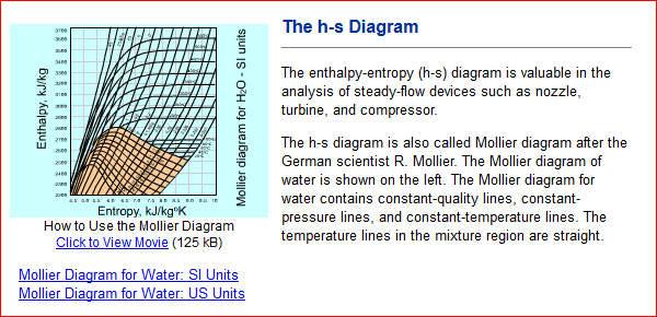

For me entropy is a navigation aid to help one find where he is in the steam tables.
It's a number, just as on a channel marker, that is also written on your navigation chart to show where you are .
It's a tremendously handy tool for practical work with Moliere charts where it's the horizontal axis..
https://ecourses.ou.edu/cgi-bin/ebook.cgi?doc=&topic=th&chap_sec=06.2&page=theory
In a turbine, expansion moves straight down the chart and moisture extraction moves diagonally up along a constant temperature line.
