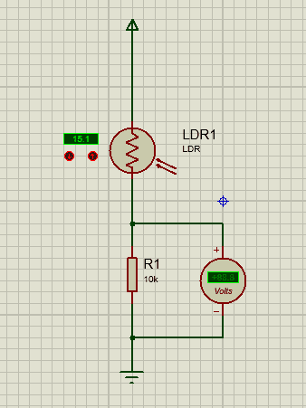

I have a micro-controller with 10 bit resolution. How can I convert the voltage or digital output of the microcontroller to a Lux reading ?
Jony130 said:
I don't have a lux meter. I noticed proteus which is the software I use for simulation has one. What if I used that to find the relationship ?
I used a circuit like this and measured the voltage

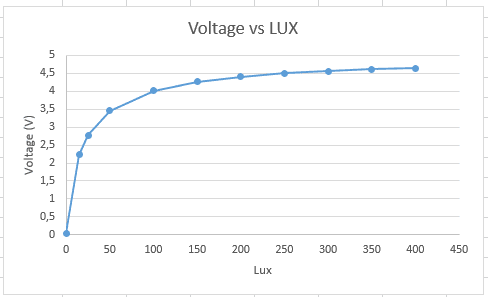

This is the curve I got
So if I find the equation of this curve, then given a voltage I can get the LUX value ?
Try to use a transimpedance Amplifier instead of voltage divider.
What would be the benefit of using a transimpedance amplifier over the voltage divider ?, From what I've read, it converts current to voltage. I haven't studied this type of amplifier yet
