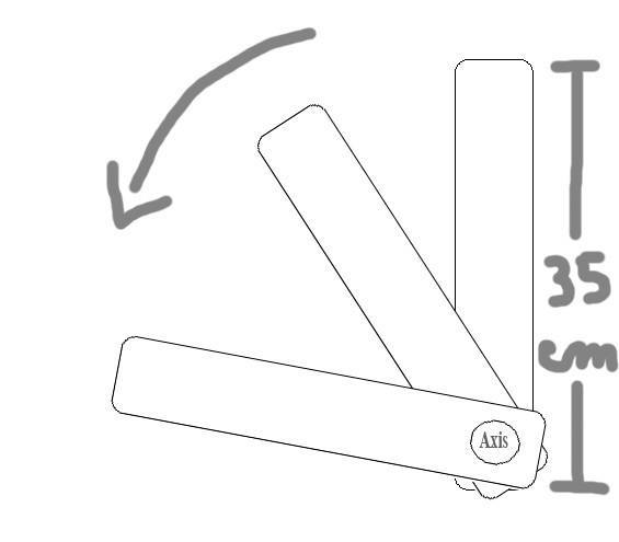

I have an iron bar (35 cm long) hinged on an axis. The path of this bar is limited to 45 degrees.
I have to measure the angular velocity of the bar when it rotates 45 degrees. I need to get a graph of variation of the angular velocity along the 45 degree paths. The time taken to cover 45 degrees, is about 20ms
This is still rather ambiguous. Can you explain a bit clearer and post a picture ?
I have attached a photo.
Diagram of a rigid bar pivoting about a hinge labelled Axis at its right end, showing three positions of the bar: vertical, tilted, and nearly horizontal. A curved grey arrow indicates rotation counterclockwise, and a vertical dimension marked 35 cm spans the length of the bar.
  • Diagram of a rigid bar pivoting about a hinge labelled Axis at its right end, showing three positions of the bar with a curved grey arrow indicating rotation counterclockwise and a grey dimension bar marked 35 cm along the vertical bar's length.
I would put a protractor in the background, then take a video. From the video you can see change in angle frame-by-frame.

And what is it that causes the anglar motion ? Where does the angular motion starr ?
Where is the 45 degrees limitation you mentioned in your post #1 ?
Is there any source of friction at all ?

I need angular velocity and not only angle.
If your video takes 30 frames per second, and if you measure a difference A in the angle from one frame to the next frame, then angular velocity is 30A degrees per second.
The angular motion is caused from a click of a spring that I can not known.
