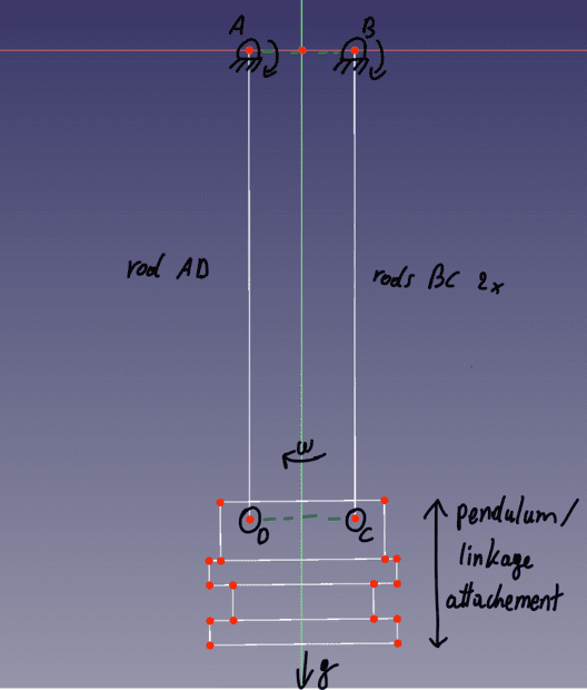

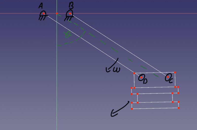

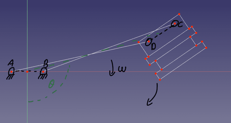

Hello, I'm new here and I'm looking for advice regarding some calculations of a device I constructed/should construct.
It's a 4 bar (parallel) linkage system, which is used like a pendulum. It is released from a certain height, with just the gravity acting on it. linkage pendulum.pnglinkage pendulum 2.png
I understand how to calculate the potential energy and kinetic rotational energy for a simple pendulum consisting of a rod with an attached mass, using the moment of inertia. However, with this linkage system, I don't know how to include the moment of inertia for the rod AD and the rod BC, as they are turning around a separate axis. To make it even more difficult, the rods are crossing each other once it reaches a certain angle/height, twisting the attachement.
(While in theory I think this shouldn't be the case for a perfect parallel system, here there's a minimal, but I think negligible length difference between the rods AD and BC).

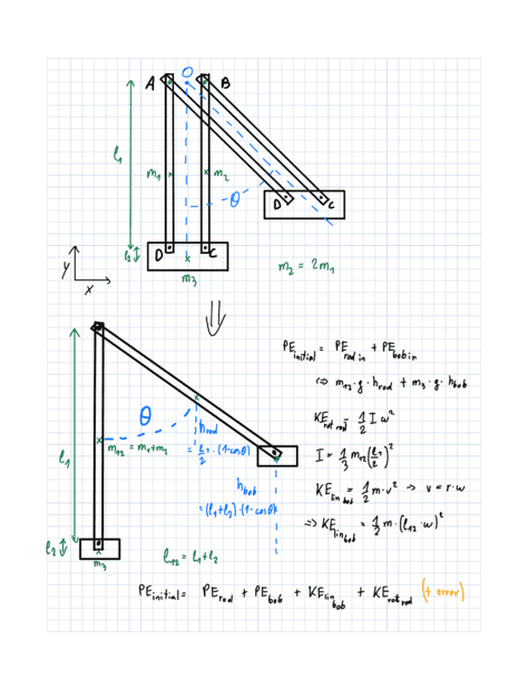

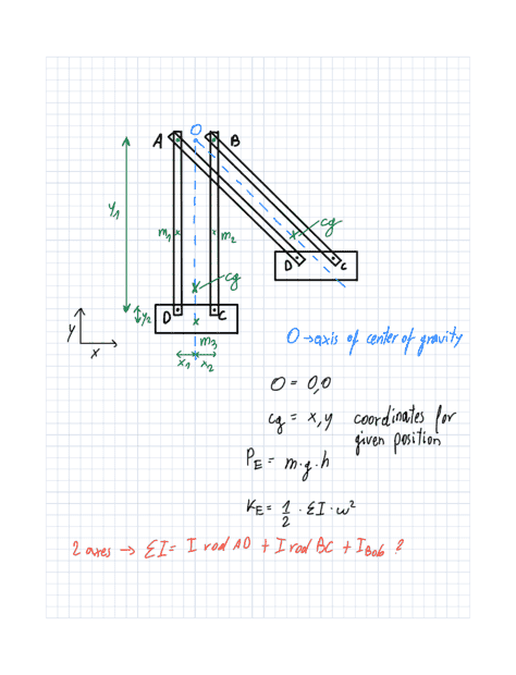

linkage pendulum 3.pngHow should I proceed to calculate the angular velocity at the center of gravity of the device?
My approach:
1. calculate the center of mass in a certain position.
2. calculate the potential energy in this position.
3. calculate the angular velocity based on the potential energy and kinetic rotational energy. However, at this step I don't know on how to include the moment of inertia of the 2 rods, which have 2 different axes.
For steps 1 and 2: I think once the twisting of the attachement is reached, the center of gravity is changing constantly, making it necessary to maybe solve the equations for the angular velocity step by step?
The length variation of the parallel links should be less than the clearance of the pin bearings. If such a change is not implemented in the model, the angular acceleration of the load could become extreme as it passes through the 90° point. Something must/will give to eliminate those huge forces associated with rotation of the load in the model. The links could stretch, the pins could bend, or the bearings could have some slack.

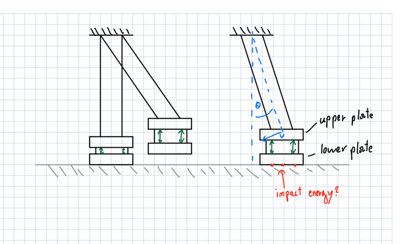

First: The rods are made of metal with holes drilled in them, and threaded bars are used as axes. There are no bearings yet and there is definitely some play in every direction, as the construction itself is just a prototype and not very precise, but it's working. To simulate the movement in my sketch (here: Freecad), I had to make one rod minimally shorter than the other one, in order to replicate the crossing of the rods.
Second: The attachment consists of an upper and lower plate, with the lower plate being able to move up and down. Once the pendulum is released, the lower plate will hit the ground and will be pulled over the ground by the upper plate. A full 360° turn isn't intended.
Therefore, for now the goal would be to calculate the angular velocity based on a certain starting position with regard to the moments of inertia of the different components.

Okay, hopefully I've got your point correctly: by angular rotation you mean the angular rotation around every joint, by every rod/bar? And once it starts twisting, the calculation can become impossible/difficult as it is not sure in which direction the twisting happens once it is released?
However in the constructed device, the rotation of the bob is always happening in the same direction and it works 'flawless', maybe because it is free to move horizontally by about 1 mm or because it has play at the holes for the axis.
Is there any way then, I could do a raw estimation/calculation of the expected speeds of the centre of the attachment when it is released from a certain height? E.g. break it down to resemble a simple pendulum and then calculate the potential energy and kinetic energy from there on?

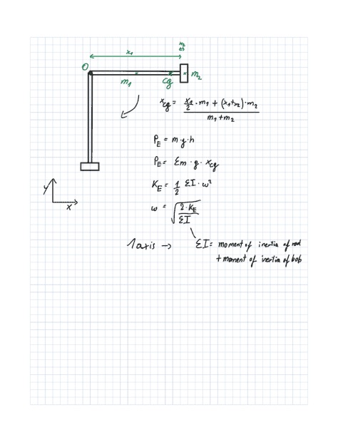

Yes. Conservation of energy tells you that the potential energy at the height it is dropped from will be converted to kinetic energy at the lowest point. Assume the bob remains horizontal.
½·m·v² = m·g·h
If the suspension rods are light weight, you might initially ignore them. Then you do not need to know the centre of mass of the bob, only the change in height.
The suspension aren't light weight, they account for over 50% of the total weight. And that's were I struggle in how to incorporate them into the calculation.
For a pendulum turning around 1 axis, you take the moment of inertia of the rod and the bob to calculate the velocity at the centre of the gravity the whole system. But how do you do it in this case with 2 rods turning around 2 separate axes?

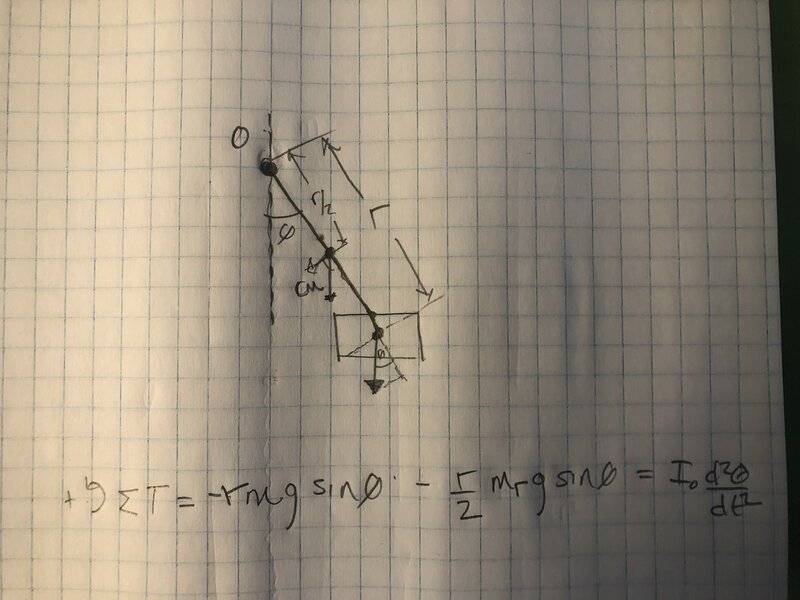

Is it possible to use an imaginary turning point O on whose axis the centre of gravity lies, in order to simplify the calculation?
Since the rods are now moving in parallel, you can simplify the analysis by modelling one rod having twice the mass, halfway between the original two rods.
Since the bob does not rotate, you treat the bob as a separate body.

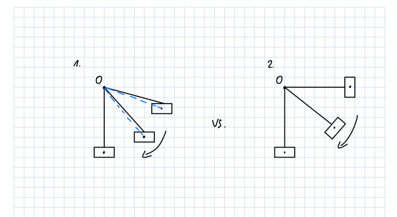

Concerning the bob, how should I treat this one as a separate body? As it remains parallel and therefore not changing its orientation, does this influence the moment of inertia, respectively the calculation?
Here you have 2 cases.
- Case 1: the bob remains parallel to the ground.
- Case 2: the bob changes its orientation.
In case 1, the center of mass of the bob changes it orientation compared to the center of mass of the rod? While in case 2, both remain on the same line.
I think in case (2) you treat the MOI (for the hung mass) as:
$$ I_O = I_G + m r^2 $$
and in case (1)
$$ I_O = m r^2 $$

grvlfun said:
Please correct on what steps are wrong and would you also please elaborate in how to perform this 3 way split?
0. We assume for the computation that the bob does NOT rotate.
1. The three rods remain in the structure, but are treated as one virtual rod during computation.
2. The centre of gravity of the combined rods and bob is not required. Since the bob does not rotate, only the velocity and height of the bob is important. Assume it is a lump at the end of the combined rods.
3. Specify the angle of the rods. The height of the bob, and the virtual rods CofG position is then known.
4. Use an iterative, or similar to Newton's method to solve for angular velocity, start with a guess, or use the previous value of the angular velocity. Repeat step 5 to search for error zero.
5. The solution will be the angular velocity when energy is balanced = conserved.
PE( initial ) = PE( rods ) + PE( bob ) + KE_linear( bob ) + KE_angular( rods ) + error.
6. You will have computed the wanted linear velocity of the bob.
and in case (1)
$$ I_O = m r^2 $$
actually mentioned for case (1). Why? Why is the MoI here just m*r2 and the distance to the axis is not taken into account?
The total MoI isn't ## mr^2##, that was just the MOI of the Bob ( when its not rotating with the assembly ).
The Total MoI of the system about ##O## :
Let:
## m_r## be the mass of the "virtual rod"
## r ## is the length of that rod
## I_r## is the MoI of the rod about an axis parallel to the axis of rotatiation passing through its CoM
## m ## is the mass of the bob
Then using the Parallel Axis Theorem:
$$ I_O = I_r + m_r \left( \frac{r}{2} \right)^2 + m r^2 $$
Does that answer your question about the MoI better?

The attachment on the linkage consists of 2 plates. An upper and a lower plate. The lower plate can move up and down freely. It is intended that the lower plate hits the ground before angle θ is 0 and is dragged over the ground by the motion of the pendulum.
How could I calculate the impact energy of the lower plate?
I don't expect the impact energy to be PE(initial)rod + PE(initial)bob, nor PE(initial)bob alone, as not everything hits the ground.
At the instant of contact, you could separate the bob into two separate masses. But you have not specified if the impact is “backed” by the lower mass or by the original total bob mass. How are the two parts of the bob physically connected?
Toward the end of the swing I would expect you to be interested in the horizontal component of the contact, like you were launching a puck across a frozen lake. You have not specified if the direction of impact includes the horizontal and vertical components, against an unknown hard or soft surface, with or without friction.
"Impact energy" seems a little vague. Are you asking for impact Force maybe? This motion is starting to get more complex. I've personally never solved this typed of a problem, but I'd like to think about it.
I'm thinking that the bottom plate and the posts must be guided through the top plate as it continues to sink. Thus, the lowers acceleration in the y direction once it makes contact should be 0 over the duration of contact.
I would think you calculate the potential and kinetic energy just before impact. From there you apply Newtons Second Law in the vertical direction to a FBD of the lower assembly.
What do you mean by backed? The upper plate is fixed to the swinging rods. The lower plate is fixed via a linear rail system to the upper plate. So its only movement path is up and down (y axis), can't go left/right, front/back. I would say the impact is only backed by the lower mass and not the full bob mass.
Once the lower plate has hit the ground, it will be dragged over the ground until it is lifted off again due to the pendulum motion. After the initial impact, the second phase would be dragging: here, the mass of the lower plate exerts a certain pressure on the ground.
The hardness/softness of the ground vary and the friction coefficient varies as well, due to different materials used.
I actually just need the impact energy. Like from a free fall, where you let fall a steel ball onto something and its impact energy will be the potential/kinetic energy.
For the impact force as you stated I either need the displacement distance or the collision time. I don't have any of them and I may get to use a force plate to catch the impact forces.
Based on your answers I recognised that I simply missed the fact that KE = 0.5*m*v2 and that one can split the linear velocity in vx and vy. I was thinking in the direction of using the acceleration of the bob point mass and then PE = m*a*h...
So, as I have the velocity, I will separate the bob into 2 masses, and calculate KE = 0.5*mlower mass*vx2.
Question: The bob/attachment is treated as a point mass. With its size and v = r*ω, the lower mass has a certain distance to the end point of the rod. By separating the bob in 2 masses, should a change in the distance r be included or just kept the same distance of the point mass?
## r ## should be at the CoM of the bob, and the EOM change once the lower plate has contacted the ground (so there is no need to change that). The EOM for the bob once its sliding should be based on both the FDB of the bob and the FBD of the rod which are coupled through the contact force between the top plate and the bottom rods sliding through it as the bob is translating horizontally.

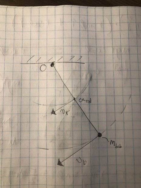

Since the bob does not rotate, it is the linear velocity along the circular path that is important, not the CofM. The height of the pendulum fulcrum should be selected so that the lower part of the bob contacts the surface at the appropriate rod -angle, then lifts off again at +angle.
The bottom of the bob will contact the surface before it slides along. The vertical velocity at that instant of contact is due to the velocity of the bob along the arc of the pendulum. The shorter the contact angle, and the softer the surface, the more gentle will be the impact.
Since the two parts of the bob are attached, the horizontal progress of the bob along the surface is driven by the angular momentum of the rod and the horizontal linear momentum along the arc of the total bob mass. That is what I meant by "backed" by the total mass.
The mechanism has three rods to keep the bob level. The model only has one rod to make computation tractable. I still don't know what is being engineered here.
Likes erobz
The device should simulate an impact + sliding over a very short distance. The first idea was a pendulum with 1 rod, however this wouldn't keep the attachment level. Therefore the 4 bar 'parallel' linkage.
The 3 bars are a result of the construction: rod AD is mounted on the middle of the D axis of the attachment. BC consist of 2 rods mounted on each side of the attachment at axis C. Point B consists of 2 axes each side, not connected to each other, so rod AD can pass by once it's turned > 90°.
Like already said, the attachment consists of an upper and lower plate, with the lower plate being able to move up and down. By varying the distance between the 2 plates, one can vary the distance the lower plate is dragged over the ground. The same goes for the radius/length of the rods.
All in all its a tradeoff between velocity, impact energy and distance but for now it's the 'easiest' and most space saving method.
Thanks to your initial hints I recognised a design flaw with the twisting at >90°. I will try to make it a real parallel linkage, in order to eliminate the twisting and simplify the calculations.
I really appreciate your help and got a much better understanding of the physics behind it. I also understood now (at least I think so) why the bob is treated as a point mass and has linear movement.

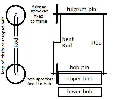

I would be more interested in how the mechanism could operate above 90° with the three rods suggested.
I would design it with one link on either side of the bob, with a chain or stepped belt and two equal sized sprockets, so the bob would remain horizontal while it passes over the top without tangling it's rods. That also eliminates the problem of parallel link length and clearance as the bob is passing 90°.
