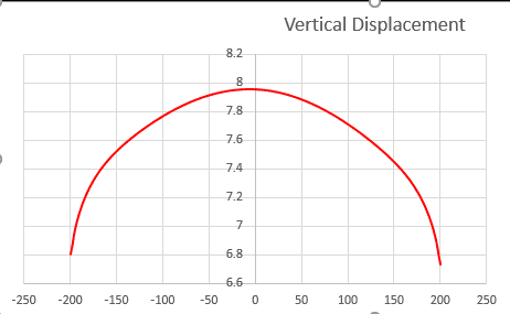

What I mean is that Y currently has values at approximately 6.7 and 6.8 at X=±200. Since I need the values of Y to be zero at X=±200, I believe that I need to transform/rotate the entire set of data in order to keep the shape/integrity. Did this clear it up at all? I can try to explain further or attach a graph of what I mean if that helps. Thanks for the quick reply.

Okay, right, so the Y values(slope/displacement) need to be zero at the endpoints of +- a given length(say L) because I am trying to reproduce the curve based on an equation that I derived from a differential equation of a bent beam (Bernouilli-Euler eqn). In deriving the equation I set the boundaries to be zero at +-L/2. So in order to match the curve from the data to the curve that I'm producing from my closed-form equations, I need the boundary conditions of the data to be the same.
The data currently looks like the attached plot.
  • Line graph titled Vertical Displacement: a red curve arches from about 6.8 at x = -200 up to a peak near 7.97 at x = 0, then falls to about 6.7 at x = 200.

Ah, that's not what I expected. I expected a Gaussian distribution of your y-values.
If those values are measured displacement values, then I don't see how they would be compatible with zero slope. You must have some weird source of measurement error that you have to identify first before you can correct it.
Zero offset is easy - subtract 6.8 from all values.

I did some research and it looks like a 2D conformal transformation might work? I understand the subtraction will work to bring us down to zero but only for one point, they are not both at 6.8. Also, they won't be compatible with zero slope - it's the case that my equation contains variables for the moments C_1 and C_2 and I intend to make a small application that will find the best ratio of C_1 by C_2 to give the smallest slope error when combined with the data. There also shouldn't be a measurement error - it's from a really well put together FEA model - the asymmetry comes from an asymmetric heat load deposited on the beam. Let me know if you need more details.

Hmmm... are you saying that I can't rotate this data so that the endpoints respect my boundary conditions while maintaining the same shape? I'll attach a short derivation of the equation for deformation(y) with respect to beam/mirror length(x). I may not have explained it properly.
Currently the shape is parabola-like. The two ends point in different directions. You cannot make them point in the same direction (well, 180° apart) without changing the shape.

Okay, right; I don't want them to point in the same direction, it's just that one end is slightly lower than the other so after a linear translation, I should be able to rotate them a bit so that the ends are at y=0 for x=±L/2. I guess the x-coordinates will transform as well in this case. I understand that once I add the my own analytical(and opposite) curve, I will not be able to get it completely flat.
