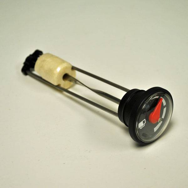

This is my favorite kind of float gauge:
The middle twisted blade (1-turn) is connected to the dial indicator and it turns as the float goes up and down. Usually found on gas tank for small vehicles like snowmobiles or lawn tractors.
