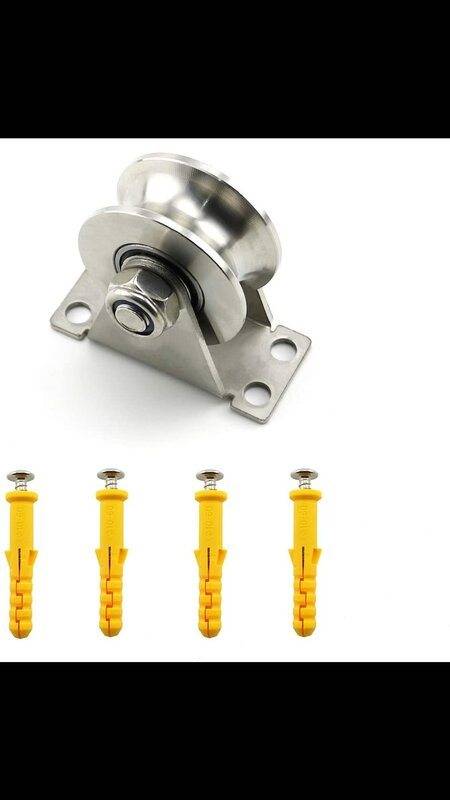

Will send you updated drawing with dim to get you an idea. I have to use rud lug to lift overhang plate. I calculated torque to 2.2 kNm each so will the rud lug of 3T on each be sufficient ? How to determine what size rud lug to use ? It will be weld on.
Second question come to my mind is pulley has to tight fit (bearings and sheave and screws) or need to have movement for load carrying ?
Do we get readymade mounted pulleys like d one attached with bolt holes on ground or have to build around sheaves ? For 8mm rope you need 100mm dia or 4in dia sheave.
Regards,
Yashi
