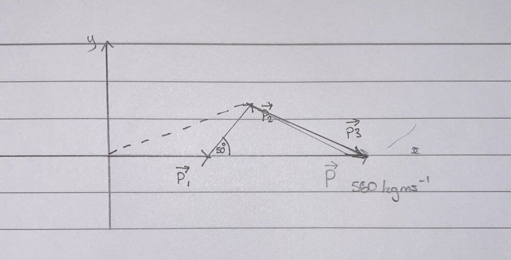

What I am struggling with is actually constructing the vector diagram to show this.
I have attached a rough sketch of my preliminary approach. However, I am rather stuck on how to find the angle of the third fragement. Moreover, would the vector diagram exhibit the momentum of the pieces or rather their velocity? I have shown it with momentum but in hindesight I am uncertain.
I have not had approached a problem where I have to find the missing vector in this way before, typically if I am using a vector diagram for say three vectors I am doing so to find the resultant force and angle.

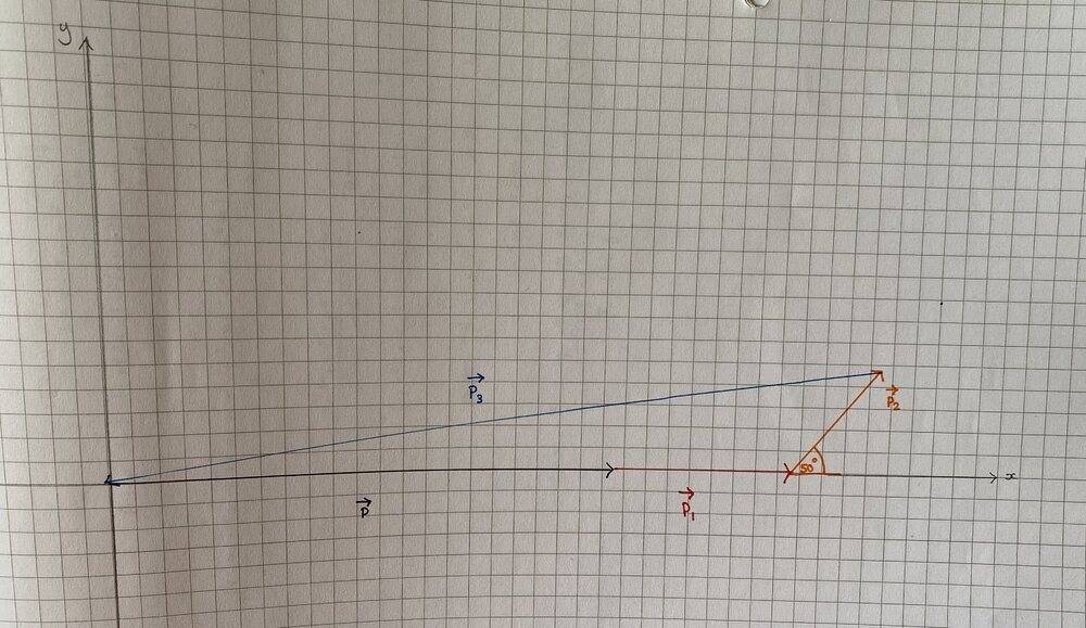

Thank you very much for your reply. I will go and draw this diagram now and then upload a picture...
I am still a little confused, should the vector P3 follow the direction of it as the dotted line, in which case the angle it makes would be between this line and the x-axis? Or would it be from the end of P2 to the end of P (the solid black line marked P3 in my diagram?)
Thank you very much again for your help I very much appreciate it!👍
  • Hand-drawn vector diagram on lined paper with x and y axes; vectors P1, P2 and P3 are drawn with P1 at 50 degrees to the x-axis, and the total momentum P is labelled 560 kg m s^-1 along the x-axis.
Good work. I would erase the dotted line from that diagram. The solid P1, P2 and P3 are drawn where they should be.
So now you are at the point where you will need to use trigonometry, coordinates or ruler and protractor to figure out ##\vec{P_3}##

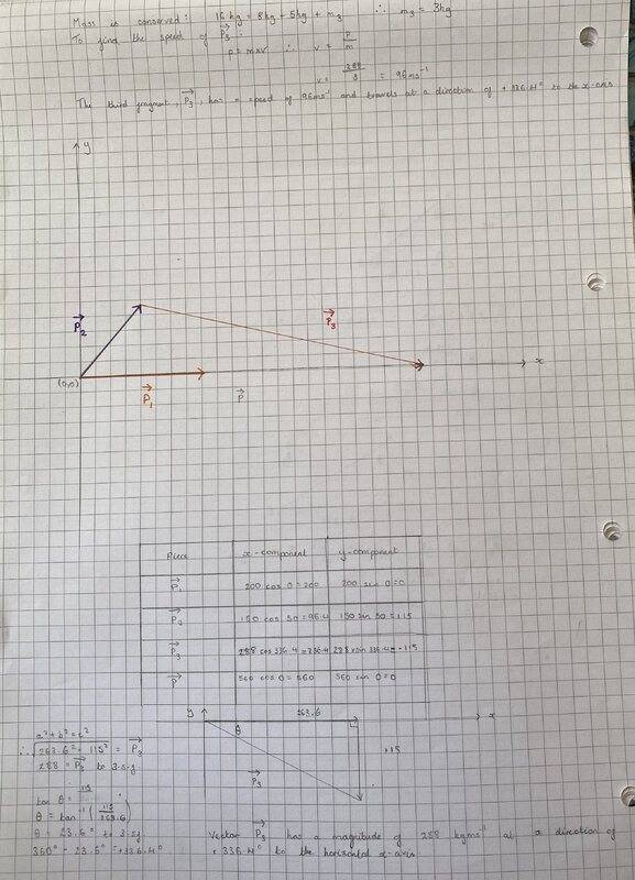

Piecex-componenty-component
P1200 cos 0 = 200200 sin 0 = 0
P2150 cos 50 ~ 96.4150 sin 50 ~ 115
P3
Total560 cos 0 = 560560 sin 0 = 0
x-component of P = 560
P1, P2 and P3 have to add up to the x component of P, therefore;
200+96.4+P3=560
P3=263.6
y-component of P=0
P1, P2 and P3 have to add up to the y component of P, therefore;
0+115+P3=0
P3=-115
How would I proceed to find the angle from this knowledge?
Would the x-componet of P3 be;
210 cos θ = 263.6
And the y-component of P3;
210 sin θ = -115

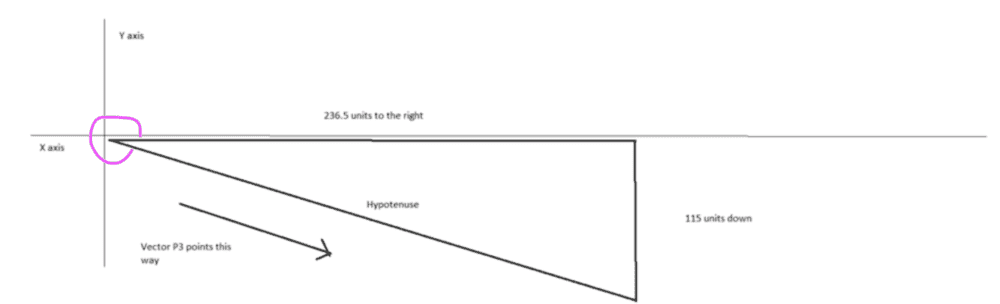

Let us use trigonometry to find the angle of vector ##\vec{P_3}##. We know its components: ##\vec{P_3}=263.6x - 115y##
Draw that as a right triangle A B C with the point A at the upper left, point B 263.6 units to the right and point C 115 units down from there. The hypotenuse of that triangle is your vector ##\vec{P_3}##.
How long is the hypotenuse? That is the magnitude of ##\vec{P_3}##.
Look at angle A. Can you figure out how to compute it now?

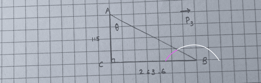

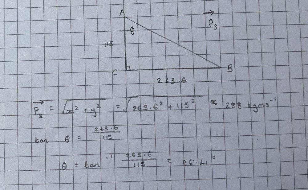

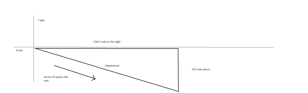

Oh I see that I was wrong. I have tried to draw the triangle ABC, I am not sure if I have done so correctly.
So to find P3, the hypotenuse;
P3=√236.4^2+115^2
P3=√82709.96
P3=287.5933...~288 kgms^-1 to 3.s.f
Then the angle at A;
tan θ = 263.6/115
θ=tan^-1 (263.6/115)
θ=66.4299...~66.4 degrees
  • Handwritten right triangle ABC on grid paper, with vertex C at the right angle, side AC labelled 115, side CB labelled 263.6, angle at A marked theta, and vector P3 drawn along the hypotenuse direction; below, working gives P3 = sqrt(263.6^2 + 115^2) ≈ 288 kg m s^-1 and tan theta = 263.6/115, theta = tan^-1(263.6/115) ≈ 66.4 degrees.
P3=√236.4^2+115^2
P3=√82709.96
tan θ = 263.6/115
The angle in the problem statement was an angle from the horizontal. The angle you just computed is an angle from the <what>?
Sorry, right so would the angle be;
tan θ = 115/263.6
θ=tan^-1 (115/263.6)
θ=23.5700...~23.6 degrees (shown as pink in my diagram)
Would this be the angle we are trying to find or since the horizontal is measured anticlockwise from the x-axis would this be the ange I have shown as white in my diagram, ie. 180-23.6=156.4 degrees?
Also, was the magnitude of P3 I calculated earlier correct?
tan θ = 115/263.6
Yes, I agree with the magnitude. You correctly used the Pythagorean theorem.
I do not agree with the angle. In which direction does vector ##\vec{P_3}## point?

You have a vector ##\vec{P_3}##. You know its coordinate value: (263.6, -115).
Here is how I would draw the triangle:
Diagram of a right triangle with its horizontal leg on the X axis labelled 236.5 units to the right and its vertical leg labelled 115 units down, the hypotenuse running from the origin, with an arrow labelled Vector P3 pointing down and to the right.
Oh oh thank you that has helped tremendously. So we would be trying to find the angle between the x-axis;
So, tan θ = 115/263.6
Would this be measured anticlockwise to the x-axis;
360-23.6 =336.4 degrees?
  • Hand-drawn diagram of a right triangle below a horizontal x axis with a vertical y axis at the left; the top leg is labelled 236.5 units to the right, the vertical leg 115 units down, the hypotenuse is labelled, and an arrow marked Vector P3 points down and to the right along it.
You could call it -23.6 or +336.4 or "23.6 degrees below the horizontal".

@jbriggs444 Ok, thank you for your help. I have tried to answer the question fully on one piece of paper, which I have attached to show my workings. Would the vector diagram showing P1,P2,P3 and P be correct because having found the magnitude of P3 to be 288kgms^-1 this does not correspond to the length of P3 in the diagram, which I believe is significantly greater.
Would my diagram and solutions now be correct?
  • Handwritten momentum vector diagram on graph paper with x and y axes, showing vectors P1, P2, P3 and resultant P from the origin, plus a table of x and y components and a right triangle for finding the angle of P3.
It seems to me that the vector diagram you show in this last post can’t be correct.
Sorry, I can’t read the rest of the text and calculations in the picture.
The sequence of after-explosion momentum vectors should start at the tail of the before-explosion momentum vector and end up at its head.
The reason is that the summation of the momenta in the y-axis must equal zero, as it was before the explosion, while the summation of the momenta in the x-axis must equal the magnitude of the momentum before the explosion.
Thank you for your reply. Right, so if the sequence of after-explosion momentum vectors should begin at the end of the before-explosion momentum vector and finish up at its head would it appear as in the diagram attached?
Also, would you like me to rewrite my previous text and calculations in a clearer format?
  • Hand-drawn vector diagram on graph paper with x and y axes: red vector p1 along the x-axis, orange vector p2 at 30 degrees from it, and blue vector p3 running from the origin to the tip of p2, forming a triangle.
This last diagram (post 27) shows two fragments moving up, which contradicts the natural fact that the summation of the momenta of all fragments in the y-axis must equal zero, as it was for the original object before the explosion.
What is wrong with your diagram of post #9?
I don’t know about the magnitudes and directions of the vectors, but the sequence seems to be correct.
For the magnitude and direction of the requested velocity of fragment #3, I would solve these equations for ##V_{x_3}## and for ##V_{y_3}##
##\sum P_x=mV_{x~Before~explosion}=(m_1V_{x_1})+(m_2V_{x_2})+(m_3V_{x_3})##
##\sum P_y=mV_{y~Before~explosion}=0=(m_1V_{y_1})+(m_2V_{y_2})+(m_3V_{y_3})##
