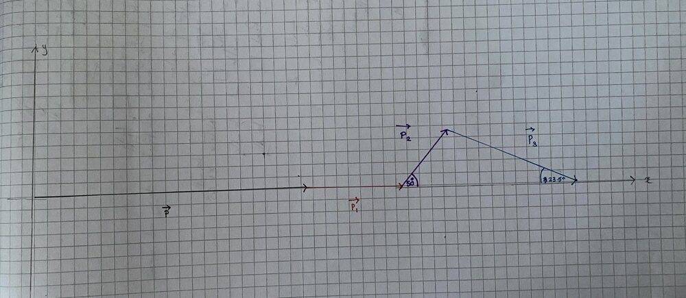

Using the information you have provided I have tried to correct my vector diagram which I have attached.
Fragment #1 (of mass 8 Kg) moving horizontally at 25 m/s, carrying a momentum of 200 Kg-m/s.
Fragment #2 (of mass 5 Kg) moving up 50° from horizontal at 30 m/s, carrying a momentum of 150 Kg-m/s.
Fragment #3 (of mass 3 Kg) moving down 23.5° from horizontal at 96 m/s, carrying a momentum of 288 Kg-m/s.
Would this be correct? I feel that I am not drawing what the question is specifying, as it asks one to use a vector diagram to find the speed and direction of the third fragment, but I think I have done so somewhat in reverse, performing calculations and using these to construct the diagram?

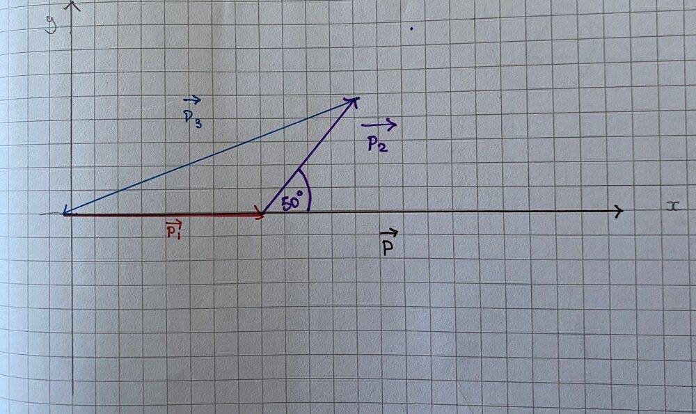

Perhaps, if I had drawn the diagram as below, resolving that P3 must move downwards to return to the x-axis as you state the "summation of the momenta of all fragments in the y-axis must equal zero, as it was for the original object before the explosion". Then, I could have either;
-used a ruler and protractor to find the angle of the direction and magnitude of P3
-or used trigonometry of the right angled triangle formed having found the sides lengths by calculating its horizontal and vertical components to find the direction and magnitude ?
Then to find the velocity of the third fragment I would use the magnitude of the P3 (the momentum) divided by the mass of the fragement, which was found to be 3kg by the conservation of mass. Would this be the correct approach?

There is no error in your diagram in post #9, vector ##P_1## should begin at the same place as vector ##P## does and vector ##P_3## should end where vector ##P## ends.
Revise this new diagram of post #31 by relocating vectors ##P_1##, ##P_2## and ##P_3## 560 units on x-axis towards the left.

Thank you very much for your reply.
Ok, I have just tried to summarise my workings to comprehensively answer the question.
I have redrawn the diagram in post #31 by relocating the vectors 560 untis to the left (see attached)

Would my vector diagram also now be correct and complete? Thank you again for all of your help I am very grateful 😊👍
Happy to help, I know that you are tenaciously trying. :smile:
Your summary is correct, you have found the requested magnitude and direction of vectors ##V_3## and ##P_3##.
There is, however, a conceptual error in the last vector diagram.
Could you tell us what it is?

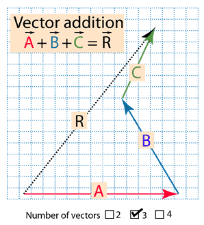

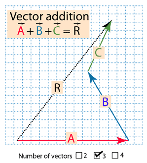

In the following diagram, consider vector R to represent the momentum before any explosion resulting in three fragments.
Consider vectors A, B and C to represent the moment of each fragment after explosion.
Note that the condition of conservation of momentum implies that vector R and the sequence of vectors A, B and C must have a common origin and end.
The momentum of the center of mass is the same before and after the explosion, whether or not the fragments are flying together or dispersing.

Exactly!
If the after-explosion vectors make a closed loop, that means that the combined or system momentum and velocity is zero, which is not what we have.
