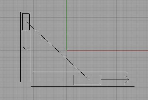

Hi ... I was trying to figure out a mechanism which allows for up and down movement. I figured a piston with crankshaft... anyone has any other possibilities?

I have a simple mchanism that is composed by 2 pistons as the attached figures shows

well it is simple , we should install a rod with a cam for the horizental piston and install an electric motor to the (cam-cranck shaft) , velocity can be easily calculated depending on the rpm of the electrical motr , but to make a full design I need configurations.
But why do you need the second piston?? You already have a linear reciprocating motion with cam!
And by the way, the linkage you showed is a double slider 4 bar chain, its an elliptical trammel
