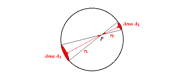

look at the calculations in paragraph II, in the opinion of the authors, the ring does not behave like a shell, the resultant force is non-null. I think that the paper is wrong, and I think I know where the authors introduced an error.
No error here. That a ring does not act like a shell is correct.
The force is not null except at the center of the ring. Take the gradient of the potential and you will see that this is the case.
Rings are used to prove the shell theorem, but the rings are carefully constructed so that the point in question lies on the axis of each ring.

Here is a simple visual demonstration that the gravity inside a ring is not null as inside a hollow sphere (in Newtonian terms):
In the above image the particle at point P inside the hollow sphere shell is at different distances from the shell but the shell mass contained in the circular intersection of the cone on the left is greater than the shell mass intersected on the right and this difference in intersected shell mass exactly compensates for the differences in distance. The regions outside the intersecting cones are identical and trivially cancel each other out, no matter what arbitary angle is chosen for the intersecting cones. See http://galileo.phys.virginia.edu/classes/152.mf1i.spring02/GravField.htm for the source of the diagram.
If a section of the shell above and below point P (the green sections in the attached diagram) are removed, leaving an equatorial ring, then some of the compensating shell mass is removed (the light blue regions in the attached diagram) and the forces no longer cancel out. Anything in the plane of the ring, but not exactly at the centre, moves outwards as if there is a repulsive force at the centre of the ring.

The proof of the shell theorem such as that in wikipedia constructs the rings so that the point in question is along each of the rings axes. That construction ensures radial symmetry.
There is no radial symmetry in this problem to take advantage of. Mercury is not located along the axis of the outer planet's orbits. It is more or less located on the orbital planes of those orbits. The projection of Mercury's location onto each of those orbital planes is not at the center of those orbits.
