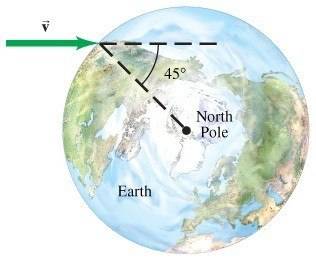

Suppose a 5.7×10^10 kg meteorite struck the Earth at the equator with a speed 3.0×10^4 m/s, making a 45 degree angle (see figure) and remained stuck.By what factor would this affect the rotational frequency of the Earth (1rev/day)?

Angular momentum is the correct conserved quantity. That means that the total angular momentum just after the collision is equal to the total angular momentum just prior to the collision. Prior to the collision you have two objects, one translating and the other rotating. After the collision all you have is one rotating object.
Is the meteor going to change the Earth's moment of inertia by any significant amount?
NOt sure... Still don't know how to set it up.
What is the total angular momentum before the collision? What is the angular momentum after the collision?
