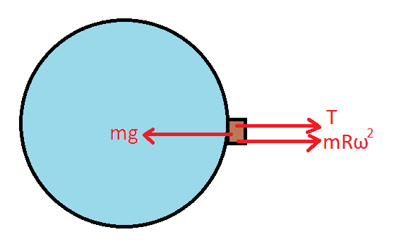

I don't quite get it. It the angular velocity of the Earth relative to the ship = ## \omega_\text{earth}-\omega_\text{ship} ##. Say for instance, my frame of reference is that of the ship which is non inertial.
From the free body diagram, I get the relation ## T = mg - mR\omega^2 ##. But in this case, shouldn't omega be the relative angular velocity of the Earth with respect to the ship.
Yes, and by definition of your problem where the ship is moving at speed ##v## relative to the Earth that relative angular velocity is ##-v/r## so ##\omega_{\rm ship} = \omega_{\rm earth} + v/r##.
No. It should be the angular velocity relative to an inertial frame.
