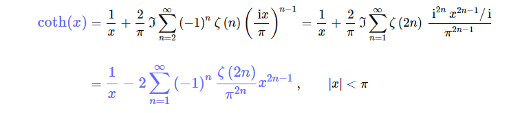

BTW from the sequence you show I expect f(x)+x is even function.
[tex]f(x)+x=x \coth x[/tex]
confirmed.
[EDIT]
Series expansion of coth(x) as 1/x plus a sum over n from 2 to infinity of (-1)^n zeta(n) times (ix/pi) to the power n-1, rewritten with zeta(2n) and a final form 1/x minus 2 times the sum from n=1 to infinity of (-1)^n zeta(2n) x^(2n-1)/pi^(2n), valid for |x| < pi.
ref. https://math.stackexchange.com/questions/1109021/approximate-cothx-around-x-0
So your way of expansion has relation with Rieman zeta function. Interesting.
Someone who has strong interest on zeta fuction might be able to find rule of sequence.
