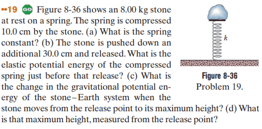

josevie
An 8.00kg stone is at rest on a spring. The spring is compressed 10.0cm by the stone. (a) What is the spring constant? (b) The stone is pushed down an additional 30.0cm and released. What is the elastic potential energy of the compressed spring just before that release? (c) What is the change in the gravitational potential energy of the stoneEarth system when the stone moves from the release point to its maximum height? (d) What is that maximum height, measured from the release point?
F=m.a =-k.x = m.g
Us = (1/2).k.x²
Ug = mgh
It is to my understanding that if the spring was compressed 10cm, it is due to the Work of the Weight Force of the stone. So:
Work done on the spring by the stone = m.g.x = 7.84 J
The work done on the spring will be stored as potential energy of the spring, so:
Us = W
Us = (1/2).k.x²
k = 2.Us/x² which gives me k = 1568 N/m, which is double the right answer of 784 N/m
I know that if I were to use Newton's second law and F(spring) = m.g, I would find the right answer. I cant, however, understand why the above method is wrong. Someone please help lol
That would be true if the stone had been released from rest at the top of the relaxed spring. But we are told it is sitting at rest on the compressed spring, which is different.
Imagine it had been placed carefully on top of the uncompressed spring and released. With no losses, it would have compressed the spring by 20cm before coming instantaneously to rest, then bounced between the two extreme positions forever. Your calculation would apply to the work done against or by gravity over that full distance.
In practice, there are losses and the stone eventually comes to rest with the spring compressed 10cm. Half the lost GPE has gone as heat, the other half into spring PE.

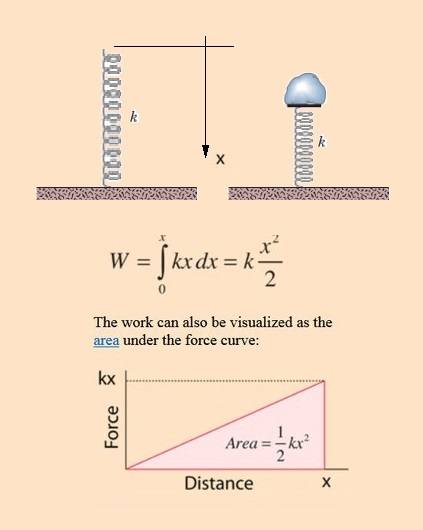

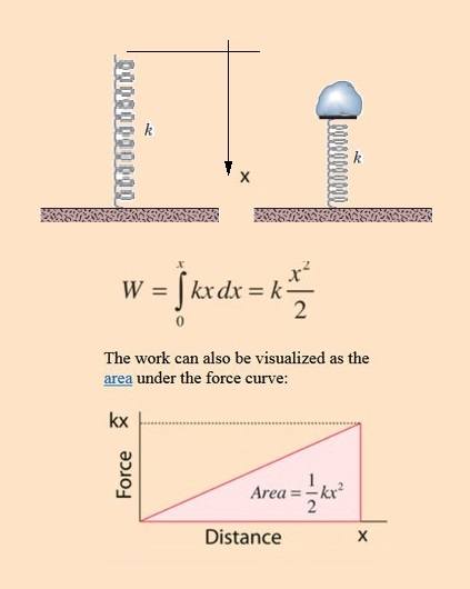

The spring deformation (effect) is a reaction to the applied force (cause).
Therefore, the full force of the weight is only applied onto the spring at the height of -10 cm from the point no load (full free extension).
At -5 cm, the applied force should be equal to half the weight.
At the full extension point, the applied force must be zero.
You have calculated the area of a rectangle rather than the one for a formed triangle under the reaction F versus distance curve.
The value of kappa (spring constant) is only the slope of that curve or proportionality constant of that function.
PLease, see:
https://en.wikipedia.org/wiki/Hooke's_law
