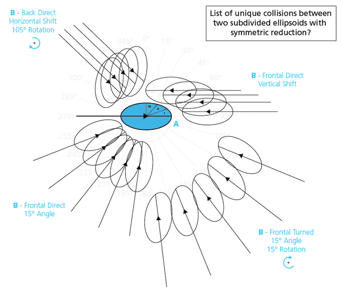

Hello,
I would like find a way to figure out how many unique collision there are between 2 equally subdivided ellipsoids (velocity=1).
When you have 2 ellipsoids and you let them collide than you have an infinite amount of possible outcomes.
The goal is to reduce this infinite number to a manageable list of for example unique 32 collisions by:
  1. Subdividing the ellipsoids, so instead of having an infinite number of points on these ellipsoids where they can hit, they are subdivided into 3 zones (I-II-III per quarter).
  2. Reduce the possible rotation angles into steps of 15°
  3. Using symmetry, to cancel out the collisions that are the same when A hits B vs. B hits A, and the outcome of a collision on the left side is symmetric to one on the right, or back and front etc.
(Note, the use of 3 Zones and 15° Angles is arbitrary, i guess once a method is found these could be easily changed into whatever.)
Attached is an overview where the Ellipse A is Set and B comes flying in (see pic.), and where:
  • B is shifted a couple of steps along the vertical-axis (right-top).
  • B is rotated in relation to A in steps of 15° (left-bottom)
  • B is rotated in relation to A in steps of 15° and B itself is rotated 15° (right-bottom)
  • B is shifted a couple of steps along the horizontal-axis and B itself is rotated 105°(left-top).
I don't know if such a method already exists or if this is perhaps something that should be solved with a Monte Carlo method or ... all suggestions are welcome to tackle this issue.
Kind regards,
m.
Diagram of ellipse A at centre with ellipse B placed at several positions and orientations around it, with arrows showing approach directions and labelled angle steps from 0° to 345°.

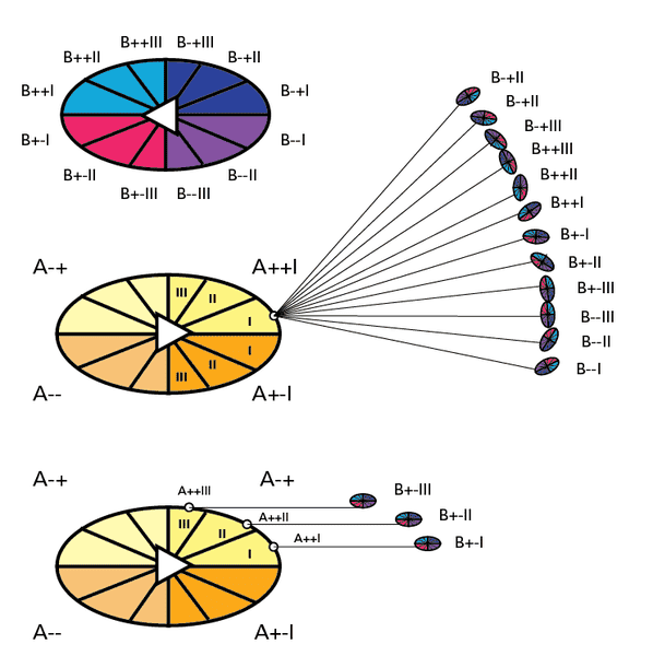

... seems like I better figure this out 'manually' ...
Diagram of three subdivided ellipses: a top blue and purple ellipse labelled B++II to B--III, a middle yellow and orange ellipse labelled A-+, A++I, A--, A+-I, with lines linking it to a column of small matching ellipses, and a bottom ellipse with labelled pairings A++III, A++II, A++I.
