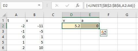

How did you get the correct answer? Is there also an other method we can use? Or is there an online tool? (Wondering)
I entered the data in Excel and used the [M]LINEST[/M] array function to get the result. (Thinking)
Ahh! Interesting! Thank you! (Yes)(Malthe)
