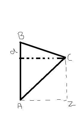

1. The problem statement,
Have to find the forces in AC & BC using the methods of section.
all variables and given/known data
Distance
AB = 79cm
BC = 63
AC = 98
d = 3.833
AZ = 62.881
ZC = 75.16
Point B is a roller and point A is a Pin
Whats given is 39.94N Forces @ C going down
ΣFx
ΣFy
ΣMa

You appear to have cut through BC and AC, and are analyzing the part with point C.
Your reaction forces at the wall appear to be correct.
I suggest analyzing the part next to the wall.

If I take moment at point A does Bx cancel ?
BC I calculated is correct?
You have BC=Bx, which cannot be. If I read your drawing right, Bx=31.79 (I agree) and taking the moments around A of the section next to the wall tells you this must cancel the horizontal component of BC.

I got the answer. I didn't understand the concept first. After reading I got it :D
