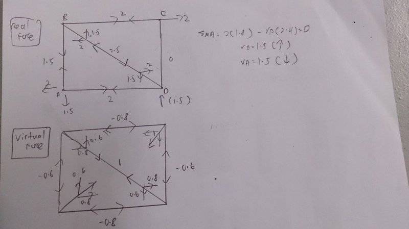

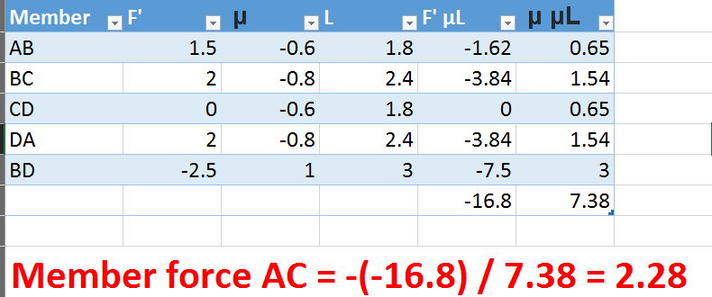

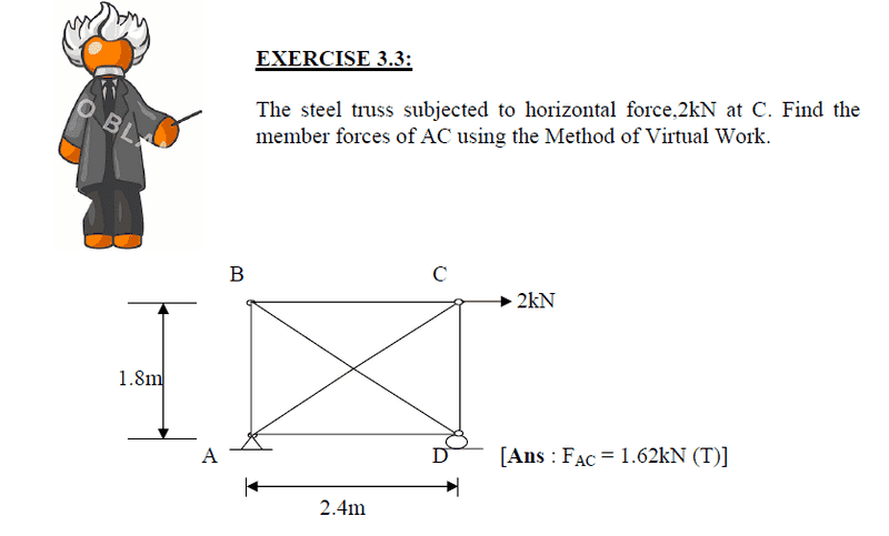

In this problem , it's a Internal Indeterminate truss .
So , I remove one of the redundant member , AC and solve the problem .
For the first part , I found the real force first . for the second part , I apply the virtual unit force at AC ...I gt my ans = 2.28 , but the ans given is 1.62 . I have checked thru my working many time s, yet I still can't find my mistake , can someone help please??
  • Truss diagram with joints A, B, C and D: a rectangle 2.4m wide and 1.8m tall, with both diagonals drawn, A at bottom left on a pin support, D at bottom right on a roller, and a 2kN horizontal force acting at C. Exercise 3.3 heading above.

  • Spreadsheet table of truss member forces with columns F', mu, L, F' mu L and mu mu L, rows AB, BC, CD, DA and BD, totals -16.8 and 7.38, and the result Member force AC = -(-16.8) / 7.38 = 2.28 in red.
  • Handwritten truss diagram with real force values on a rectangle with a diagonal member, labels A, B, C, D, and a second virtual force diagram below with values of 0.6, 0.8 and 1.
