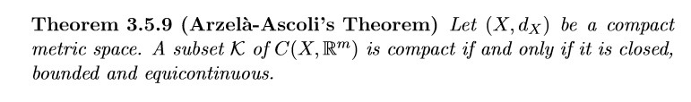

Thanks, yes it is the "converse" of a lemma in the book, leading up to Arzela-Ascoli theorem. However I wasn't able to use that theorem on it directly, because the theorem in the book was stated only for [itex]C(X,R^m)[/itex], where X is compact, but in this lemma, Y can be any complete space. But beside from that if you want to show that [itex]\{f_n\}[/itex] is equicontinuous using the arzela-ascoli theorem, then you also have to show that that [itex]\{f_n\}[/itex] is compact, and I presume that is hard?

Ah, cool thanks. But the proposition in the first post would then follow from Arzela-Ascoli if B was [itex]R^n[/itex]? Because then [itex]\{f_n\}[/itex] is compact, and hence equicontinuous. But you agree that I can't use the theorem directly when B is any space, or even if B is complete?(A is compact no matter what.)

Do they state Arzela-Axcoli only for ##B=\mathbb{R}^n##? It's true in a far greater generality. For example, there is a version of the theorem for ##B## an arbitrary metric space.
Yeah, here is the theorem:
Could you change [itex]R^m[/itex] with something more general here?
Thanks, I am taking real analysis and have not taken topology, so I must admit I do not understand much of that.
But if I want to generalize the theorem in my book. The link from Wikipedia says:
Let X be a compact Hausdorff space and Y a metric space. Then a subset F of C(X,Y) is compact in the compact-open topology if and only if it is equicontinuous, pointwise relatively compact and closed.
Now this link says that all metric spaces are Hausdorff spaces:
http://math.stackexchange.com/quest...ll-metric-spaces-are-hausdorff-spaces-correct So that is fine. The problem is the "f is pointwise relatively compact", I guess that if B= [itex]R^m[/itex] "bounded" implies "pointwise relatively compact". But that maybe if B is only a complete metric space, or arbirary metric space, "bounded" may not imply "pointwise relatively compact".EDIT: I see that for my original question this may not affect it. Because it is on the other side of the equivalence. So that if we start by saying that [itex]\{f_n\}[/itex] converge uniformly to f, and that A is compact, we must have that the limit is continuous, so that limit is in C(A,B). The open covering property says that [itex]f_n\cup f[/itex] is compact. And since we are on the left side of the Arzela-Ascoli(Metric->Hausdorff) we get that they all must be equicontinious, and we remove f?, så all [itex]f_n[/itex] are equicontinuous?
