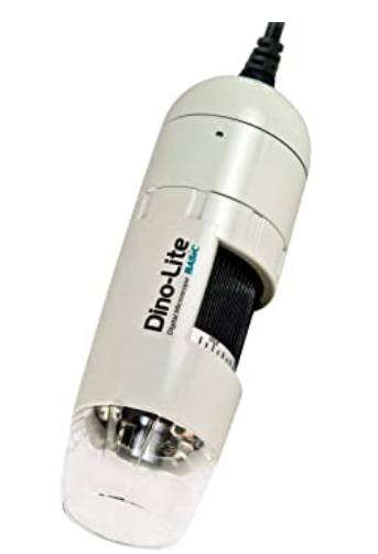

Several years ago, I bought a USB microscope from this company: https://www.dino-lite.com/. I think this is their lowest cost scope: https://www.amazon.com/dp/B00GA9QJQY/?tag=pfamazon01-20.
We bought a slightly more expensive model that had built in measuring capability. I don't remember the exact model. It was easy to use and gave high quality images. We used it to measure some part features less than 1 mm in size that could not be measured using standard measuring tools.
Likes Isopod and berkeman

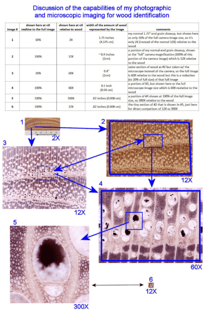

I've had good results with this model
https://www.amazon.com/Celestron-Handheld-Digital-Microscope-Pro
Here's an example: NOTE: FOR SOME REASON THIS IS ONLY SHOWING AT HALF SIZE. It's more impressive at full size

Fra said:
I think this is a really good reference.
It covers a lot of things that come up in trying to take these kind of pictures.
It also shows his scopes, which don't look cheap.
Kohler or DIC imaging is not cheap, but the oblique lighting is doable wih the right set-up.
Likes Isopod
