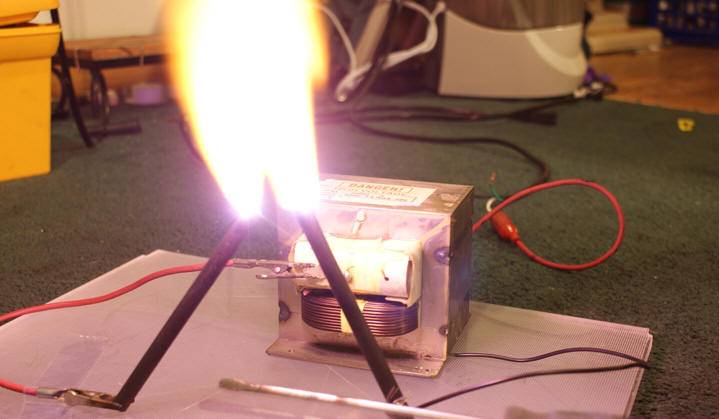

Here's what i think but do not know for certain... that is I've been unable to find basis documents for MOT design.
The shunts are primarily to limit output current, both for when a fault occurs and to limit running current to the magnetron..
Since the MOT is capable of delivering a kilowatt under normal operation, a fault can pass enough current to make a sizeable explosion.
Shunts make such a fault far less spectacular giving the primary fuse time to blow without undue pyrotechnics.
Observe the hobby guys who use them for making big arcs knock out the shunts first thing.
Note that limiting HV winding current makes life easier for the rectifier diodes that charge the HV capacitor..
So, the shunts divert primary flux away from the secondary to lower the voltage there...
Grounding the HV winding assures that a fault in the HV circuit to oven frame will quickly blow the fuse , not elevate some other part of the circuit above ground.
That's the same thinking as behind "Separately Derived System" in IEEE grounding standard 142(Green Book) and NEC.
http://adammunich.com/microwave-transformers/

I know you understand the danger involved with MOT's. They are killing amateurs.
I always admonish experimenters "Never energize a MOT until you have physically sawed off its high voltage winding" .
I strongly urge you to hacksaw the HV winding off yours when finished with your experiment.

Thanks Jim. From what you say, I’m better off leaving the MOT as it is. The current limiting is likely to give a more gentle progression of the pattern. As for the grounded frame, it’ll sit on a wooden bench, and I shall be well away from this when it’s active.
The MOT is currently stored away on a high shelf, and separately from any means of plugging it into the wall, but no, it won’t be thrown away in a usable condition.
